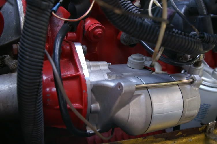

The pics shown here are of a Honda Civic starter.
TK actually used a Toyota starter (Honda parts are expensive in Oz). Many of the NipponDenso starters will fit using this method. TK's tip was to pick the ones with the longest possible "nose" so you can get the best engagement, especially if you mini has a 3/8" flywheel.

I got this info and pictures on using the Honda starter from one of our good Canadian friends (obviously when you see how much he paid at the wreckers). It was posted on the Mini Mania forum. I don't know who it was otherwise they would have got the credit.

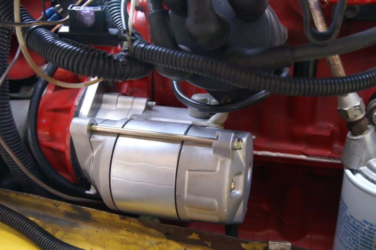

This is what the Starter Looks Like before fitting.
Now with it Fitted.
It starts The best it ever has with out any problems.

PostPosted: Tue Sep 20, 2005 3:04 pm
Oooooh, if it works half as good as it looks, you must be a happy Devil 8)

The Pics of the Honda starter conversion were from Marcel Chicaks stuff
he`s the one doin the alloy Elder crossflow cyl head with injection all set up on his engine dyno & flow bench & stuff,,,lots of stuff, he`s allways doin lots of good stuff

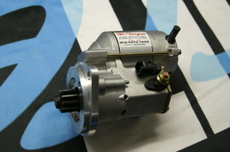

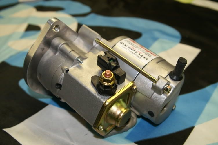

I'll post up the pic for ya mate

For the starter TK ended up with, is it similar to the one in the pics of the Honda one? & is this the same as the 1380 yellow devil? They all look like RA series Denso ones to me
So who nows how these compare to Gemini in terms of size/weight and starting?
