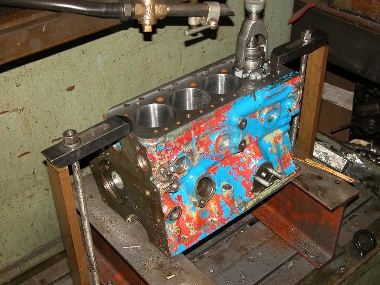

If you remember from last week the block cleaned up at +060 from stock 1275. Graham honed the bores and it has turned out nicely. He also ran a grinder across the sharp edges around the hole in between cylinder 2 and 3. After all this was completed, i left it with Graham to put it into his hot bath as the machine takes time to warm up.
A mock up of what it would have looked like when the block was on the honing machine for illustration purposes as it had already been done during the week by graham :wink:
Next week I will take it home and thoroughly clean the block by dragging cloth/cotton buds through the oil gallery ways etc. It goes without saying that emphasis must be on being as clean as possible when building the engine. All in all I am very happy with the results so far.

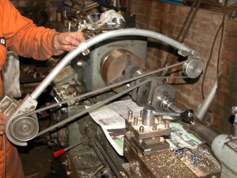

Final preparations have been made to the crank. Last week Graham balanced it on the machine and this week he took to it with the limishing belt. The machine looks like a big composite long bow or something :lol: Looks cool. It runs a cork belt which gives an exellent finish.
The master at work on the crank

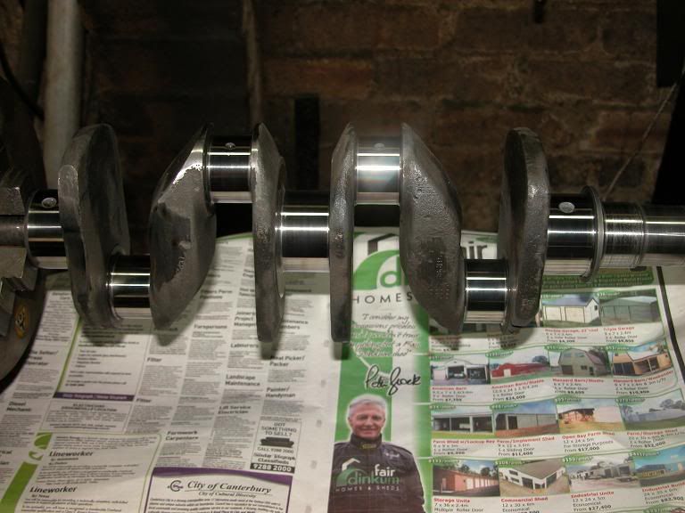

Graham also measured the journals to make sure it was all good. It seems the crank has been used before since the last grind however the wear has been minimal and actually favourable. The centre main has worn slightly less than .001 thou which graham says is pretty ok and will aid in feeding oil to the centre main (enough clearance for extra oil to be there). The rest were 010 exactly and the big ends were all 010. His comment was "This is a good racing crank Chong" 8) :wink:
The oil feed holes we left alone as they had a good chamfer already on them. Not really necessary for a road car anyway says Graham but a good to have.
The finished product. Only thing now is to wash it in the hot bath to make sure the oil ways in the crank are clean. Check out who is endorsing my crank! :P
A few weeks ago I mentioned that I was going to skip the wedging of this crank this time around. Well I was wrong! Graham says it can't be done on small journal crank such as this as they are very hard. Graham says they were factory tufftrided and therefor the milling head will do bugger all to the crank. Simply put it is not worth doing...

Great update, I especially like the picture of the crank. If you look closely, it looks like Peter Brock is doing an endorsement for your crank. :D
PostPosted: Sun Aug 27, 2006 8:54 am
Posts: 39764
That is a GOOD crank, IMO. These small journal ones were factory crossdrilled and tufftrided (hardened). They wear on the mains much less than the later (soft) big journal cranks do. :wink:

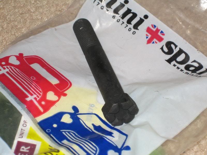

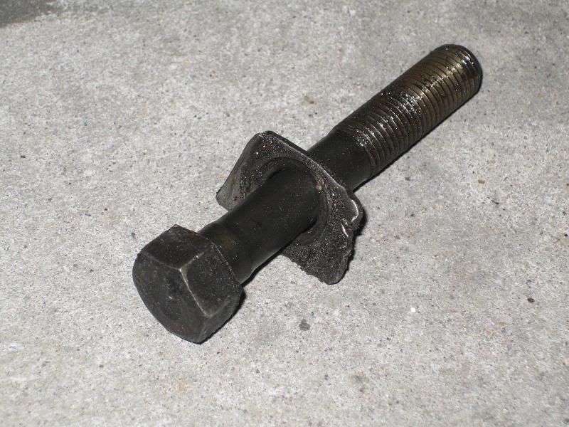

A few weeks ago both Kev and Graham had a good look at the bolts I was indending to use to hold the crank caps down with. It was unanimously decided that I need to buy new bolts as the ones I had were the weak type. So I ordered 12G1398 from the UK. That's what was part of the package that arrived today!
Original bolts. Check out the sorry state of the locktabs :?
The new 12G1398 items. I got 6 8)

Chong, Locktabs are for the Weak ....use Loctite ...(and an extra 5ft/lb torque :twisted: )

yep he knows mains locktabs are bad news. Not just here, the flywheel one sucks too. Likewise the smallbore rod bolts.
Loctite 262 is good stuff... :wink:
BTW Chong's conrod bolts for the S rods are `HPX' BB Ford items, being modified slightly to fit this week.
