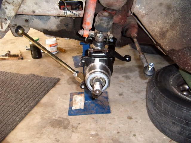

With the drive shafts fitted, we could fit the uprights:
.. and with the uprights on, the discs and drive flanges were next (although not yet torqued):
This is all going very well. Next up, fit a caliper and double-check that we have clearance to the wheel.

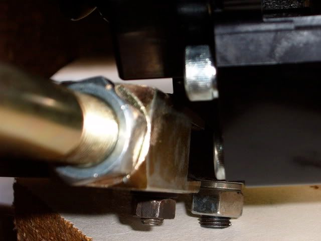

Um, wait a minute. Mini Spares said something about some undefined clearance problem between the calipers and adjustable lower arms. Better figure out what that's all about. With the car in the air and the suspension at full throw, there's a clearance problem alright. Only about 2/3rds lock is available before the caliper touches the big, square section on the caster bar:
The way I see it, I'm not likely to be asking for full steering lock while I'm getting air, so this is unlikely to be a major problem :lol: From the looks of it, it appeared that with the suspension at normal ride height the caliper would clear the arm, and it turns out that this is true:
At full lock, there's still a few millimetres between the caliper and the caster bar, so we're safe. It's a bit hard to make out from this shot, but a miss is as good as.

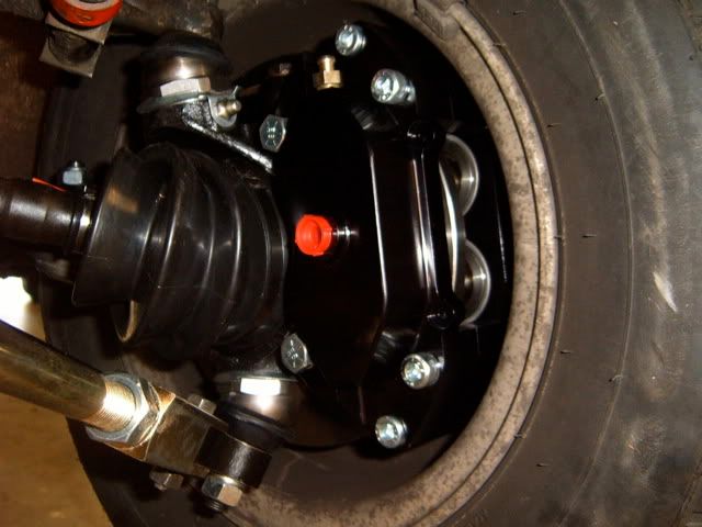

Decided the next thing to do would be to get the brakes bled. It was about now that I realised I'd fitted the calipers without attaching the brake hoses. Why, oh why isn't there a union fitted to the end of the hoses!? The calipers had to come off in order to get the hoses attached, but hey, no biggie. While we were there, we got the pads fitted up (after grinding a few millimetres of the corners of the backing plates of the inside pads so they clear the calipers).. looking good 8)
Calipers back on, it was time to bleed. I picked up a Gunson's Eezibleed with the Mini Spares order, so figured bleeding would be a snap. Not so, unfortunately -- as I suspected, the kit doesn't come with a master cylinder cap suitable for the large Lockheed plastic reservoir. As I don't have a spare cap, I ended up modifying my cap to allow the Eezibleed to fit. As a result, I now have a master cylinder cap with a bolt in it, sealing up the hole we made :shock: No photo, unfortunately.

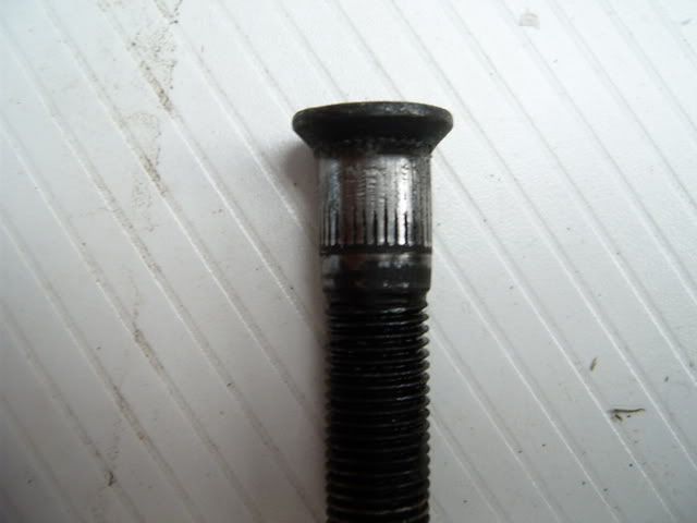

So anyway, back to bleeding. With the system nearly completely evacuated after the disassembly, the rears were the best place to start. That meant getting the rear wheels off, which meant getting the front wheels on and the car off the axle stands. While fitting up one of the front wheels, we discovered that one of the wheel studs had not been press fitted very well and spun in its seat, stripping its splines :evil: :evil: :evil:
Nobody nearby could supply me with a new stud, so it got Loctite'd in. Here's hoping it holds :?
From here, things seemed to take a bit of a downhill turn. Bleeding the brakes turned out to be a #$@* of a job. The Eezibleed probably works pretty well with the master cylinders for which it has caps, but I couldn't get a good seal with mine which meant we had brake fluid leaking all over the place. Eventually though, we got all (most?) of the air out of the system and attempted to get a pedal.
Attempted, that is.
No go. The pedal goes pretty much all the way to the floor on the first stroke, and after a few pumps comes up to about half way. Once there, pressure can be held and the brakes seem to work pretty well, but release your foot and it's back to square one. There doesn't seem to be any air in the system, we've put at least a litre of fluid through and there's very little, if any air being expelled.
I'm at a bit of a loss as to why we can't get a pedal. With drums all round, the pedal was high and hard, but now.. :?: :?: Anyone have any suggestions?
My suspicion is that the 4-piston calipers require a larger volume of fluid moved before the pads engage the discs, and the drum-type master cylinder isn't moving enough. Pumping the pedal quickly delivers enough fluid to get a pedal, and it's all returned to the master cylinder when you let the pedal go. Does that sound reasonable?

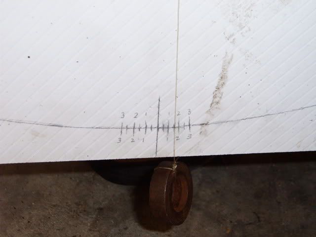

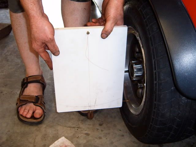

Anyway, with on-road plans scuttled and an hour to kill, I decided to have a play with my make-shift camber gauge. Amazing how easy it is to adjust -- I now have 1.5 degrees negative on each side.. a major improvement over the 1 deg negative / 0.75 deg positive with the standard arms :D

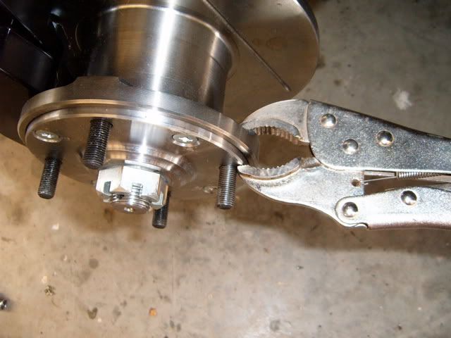

Oh, and the only other thing: Getting 150 ft-lbs of torque on the drive shaft nut is not a very nice job. Getting the split pin holes lined up once it's torqued is even less fun. Let us never speak of this again :lol:

Can tell us how you made this please (the degree markings that is)

This is a great thread!! Keep it coming, its very interesting to see the different problems and ideas. I like the simplicity of the camber guage, would make a good how to .........

:? Hmmmm, perhaps it might be worth bedding in your new pads
(on a controlled private road of course) as I think it may actually be your brand new piston seals pushing the pots all the way back.
Once the seals loosen up a bit the pots should remain partially extended, only pushed back by the disc against the pads.
Of course you can check the volume of the master cylinder against the volume of your new pots + the rear cylinders, but I doubt that is the problem.
And asking the obvious, the rears are adjusted properly so that you aren't using up fluid capacity there too?
PostPosted: Fri Sep 28, 2007 10:06 pm
Just an old trick I was told many moons ago.
Puty a plank of wood between the brake pedal and the crossmember (or chair or where ever you can jam it). Have it to it jams the pedal down hard (pump it up as high as you can so it has something to press against).
Leave this overnight or as long as you can and then bleed the system.
I think it works by squeezing all the airbubbles down to a tiny poofteenth of their original size inside the brake system. Then they suddenly find it much easier to float up to the top through all the small passages.
There's also a procedure to bleeding the wheels in the right order, can't remeber it right now but it is in the manual.
Mini brake systems are a black art sometimes.
It's really quite straightforward.
1. Drive a couple of screws into the side of the MDF at the correct spacing to sit on your wheels. Try to get them more or less even, but it's not critical. What is critical is that you don't move them once they're set.
2. Drive a screw (or nail) into the top of the board, roughly centred, and attach a bit of fishing wire. This should be long enough so that your weight (a heavy washer in my case) hangs below the bottom of the board, and can swing freely.
3. Take a pencil, hold onto the fishing line close to the bottom of the board, and draw an arc.
4. Find a perfectly vertical surface. I used one of the steel posts holding up the garage :)
5. Hold the screws on the side of the gauge up against the vertical, and allow the fishing line to hang vertically. Mark where it crosses your drawn arc. This calibrates your gauge to the vertical.
6. Measure the distance from the screw holding the fishing line to your drawn arc. Call this distance 'y'. The aim is to use Pythagoras to determine what distance (call this 'x') along the arc represents one degree. The equation for this is:
x = y * tan 1
Once you know 'x', you can make marks either side of your zero degree position which represent one degree. I found it easier to mark every degree, then mark the half degrees by eye rather than trying to measure tiny fractions of millimetres.
Voila! One home made camber gauge.
