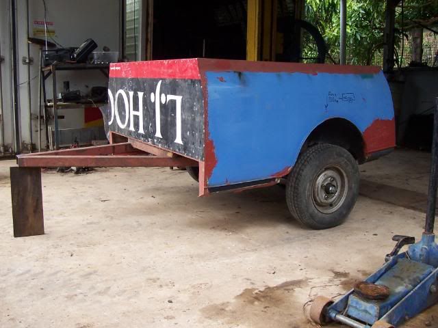

PostPosted: Fri Feb 18, 2011 11:11 pm
What about the bearing/hub centre?
Wouldn't it poke out a mile with many wheels?
PostPosted: Sat Feb 19, 2011 12:29 am
This is the same bearing and hub combo on my trailer with steel rims.
Image[/img]
A mag wheels will come out another 3/4 of an inch and then with a center cap it should just cover i reckon.
