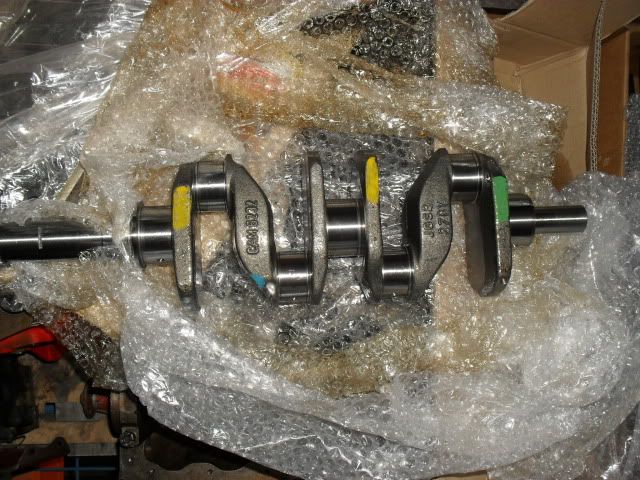

Ok, so I climbed up and got one of those virgin A+ cranks out.... I measured and photographed it all. Oh and I got a couple of pic's showing the difference in size between the flange on the thick flange 1100s v's 1275 A+

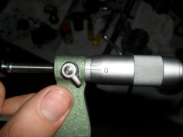

Here's the Mic, with slip gauge in, showing that its been Zero'd correctly...
Here's the A+ crank...

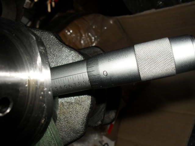

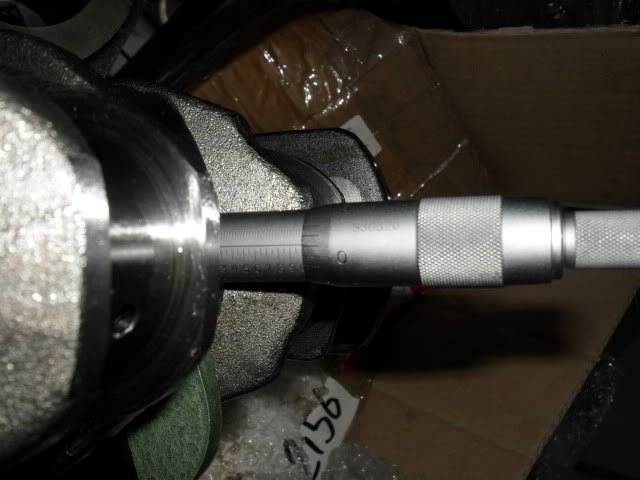

Here's the journel size..
Here's the journel size again (I was having trouble getting a good photo, not much room up there :lol: )
So the Haynes manual says "2.0011 to 2.0017" for an A+, the Factory Metro workshop says "2.0011 to 2.0017" for an A+ crank
The Black book says "2.0005"----2.001" " for a 1275cc Cooper's', Moke, Clubman GT
The Morris 1100 & 1100s manual says "2.0005 to 2.0010" for a "1275 powder unit"...
So there it all is.

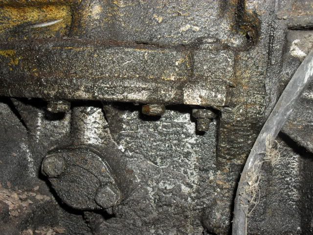

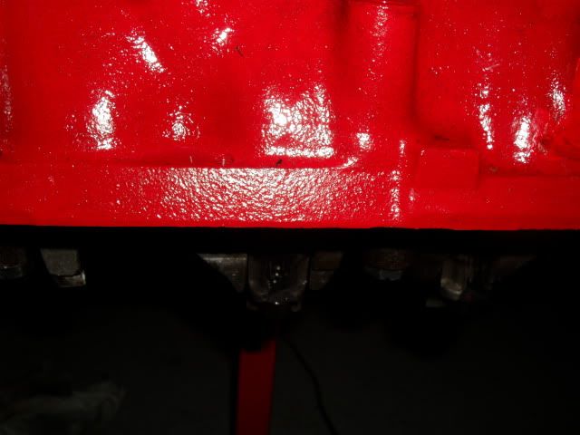

And here a couple of shots of the thick flange 1100s block v's the A+ flange. Sorry Tito, I would have got more shots of the A+ for you, but its really tight for space up in the pallet racking and I wasn't to keen on trying to move anything heavy while I was up there incase I fell :lol:
Here's the A+ flange
and the 1100s flange

OK my books don't cover A+, except the 1275 A series high performance manual by Des Hammill.
on p19 he states "the main bearing sizes are nominally 2.0005-2.001" on all 1275A+ engines."
I have seen A+ cranks like yours measure at 2.001", but never any bigger.
Leyland's black book says 1275cc Cooper S, 1275 Moke, Clubman GT are all 2.0005-2.001" also.
So, measure all you like, but provided the running clearance is correct, A series main bearings work fine in an A+. Just don't throw em in without measuring.
If you are reconditioning, you would be probably be regrinding the crank to the next undersize anyway, so size em to suit.

Using a 1-2" micrometer to measure a 2" + main journal just doesnt cut it, winding a mic past its allowable scale wont give you an accurate reading.

It's accurate enough for the injection moulds I make at work. The screw's in Micrometers are precission cut past the end of the scale. <correction> ""GOOD"" micrometers
If you like, or are still not entirely satified with the measurement taken, I will gladly crawl back up there and measure it again with a set of 2-3" mic's instead.

Hey, a whole .001" over? I think you are drawing a long bow here... :lol:
I wonder which mic you would use if it was 1.999"- a different one then??
Or would you still use your 2-3" one and wind it in my .001".
