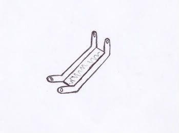

The design of the bottom locating bracket would go a long way in reducing the twisting that results in broken mount bosses.

This is a rough sketch of what the bottom bracket could look like. As you can see it would help considerably
in stopping the twisting torque with alternators with a suspect mounting boss.
If you had doubts about the mounting boss, a rose joint would be bad, as it would allow easy twisting as the motor revved up and down.
