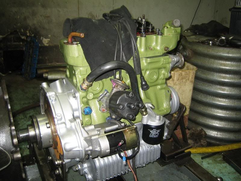

She's on the Dyno!
Handsome looking thing aint she? :lol:

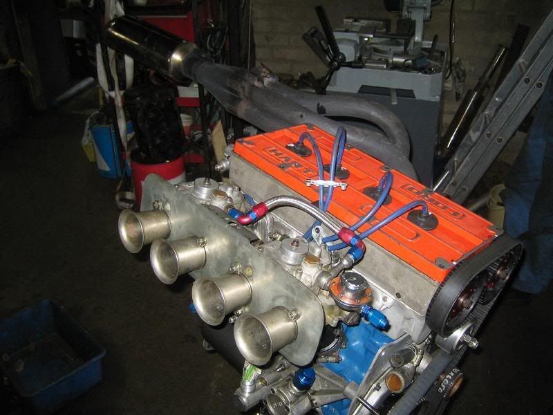

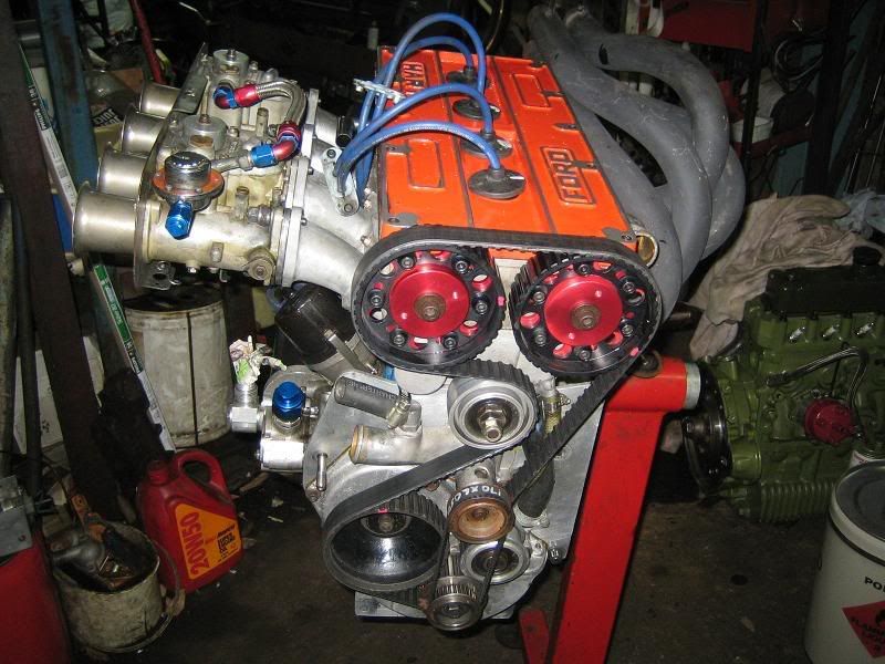

Would have run it today but this got in the way:
It's a FORD DBA (Belt Drive Assembly), twin overhead cam, 16valve 1.6L engine that got a whopping 260hp on the dyno at 9000rpm! These heads were used on Formula 1 cars back in the day.
Graham says these can go into Minis and that kits are sold in the UK to bolt them onto mini gearboxes :shock: :shock: :o :twisted:
Only problem is that this engine here (as you see it) is worth about $40,000-$50,000!!!
I SO WANT ONE! :P Sounds like an F1 car funnily enough 8)

113hp! :D :D :D
I am very very happy with the results! She pulls strongly from around 3000, reaching max torque just above that about 3500. 97ft/lbs all the way to 6500...
With Supa Pipes she did even better at 114hp and 104 ft/lbs! plus had a big 5ft/lb edge all the way up to 6500.
34mm vs 36mm was worth a puny 2-3hp only which was surprising. I think the biggest downfall as graham says is the redline intake. Although it is fully ported it is still the wrong shape and length.
As graham says I can easily extract a further 10-15ft/lbs if I adopted both the supa pipes and a GR long intake but that would mean roughly $1000 worth of gear and MASSIVE modification of Lillee's firewall, for about 15hp which works out to be about $67 per horse!!!
Maybe next rebuild when I am prepared to hack Lillee up :? :shock: :wink: mmm 130hp :wink: :P (Listen to me! I have 113hp today and I am already drooling at the future prospect of 130hp :lol: )
Dyno today was long, hot and tiring but worth while. I can now throw the engine straight in without needing to run it in or anything like that. Can take it to 6500rpm on day 1 which is a huge bonus!

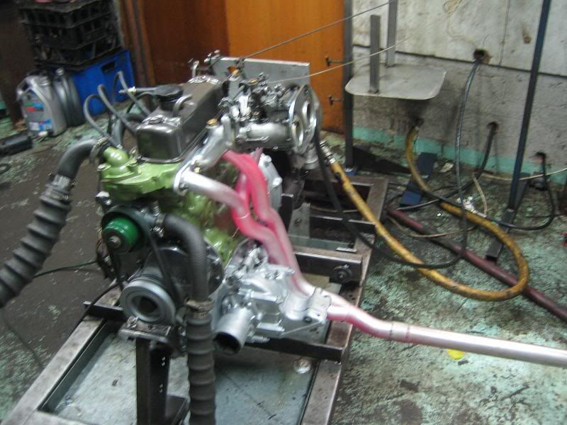

To give you an idea of how hot things got, check this out:
Red Hot Pipes!!!
The number 113
