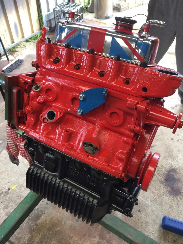

Block meets gearbox with a coat of clear gloss :D
That's head of engineering (Rodney) in the back ground.

Nice. Getting close now.

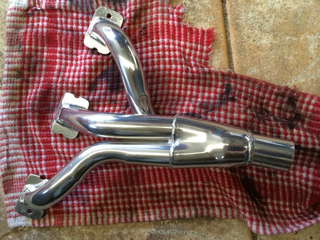

Ceramic coated header pipe is back from CIC 8)

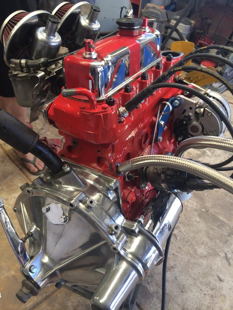

It's getting there :D
PostPosted: Thu Oct 09, 2014 6:42 pm
Holy cr@p that's a shiny clutch housing :D . Who did the polishing?
I just noticed your flywheel breather, a bit scrappy comparing to the rest of the engine :roll: .

Just spit and polish :wink: nah, it was on my old motor so I've just polished it back up myself with normal cut n polish. A new breather is on it's way from Minisport :D
