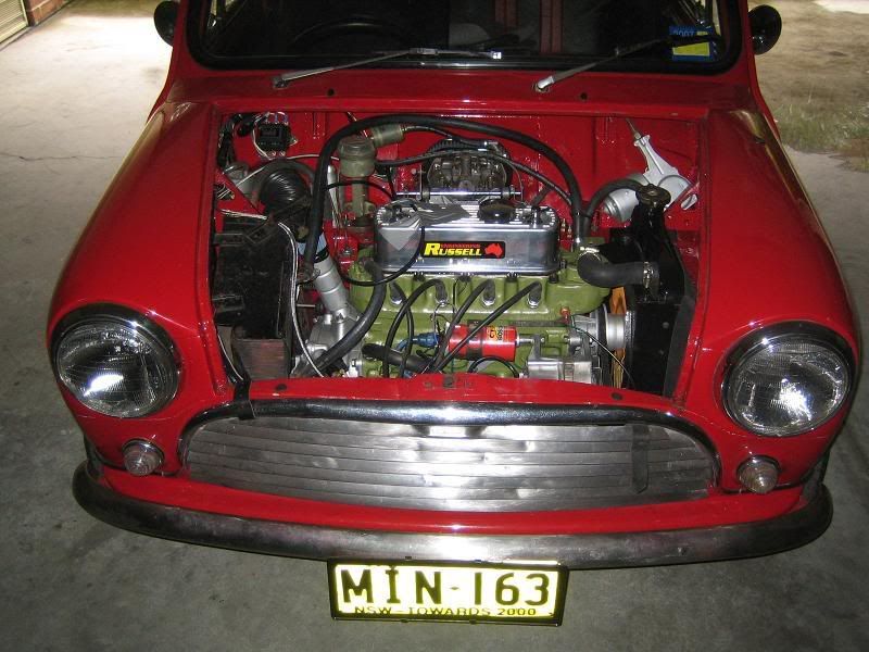

One small point (if I may :roll: ) The dizzy clamp looks to be closed up, is it actually gripping the dizzy?
These little clamps are crap, particularly if distorted over the years etc. If you recall at Wakefield when you helped out with my orange sports sedan, I had all sorts of trouble with the dizzy popping out because the clamp was knackered!
I believe a sprite guy was making neat little alloy billet clamps, lost his details for now though.
I am sure yours is fine, just maybe tightened, then tightened that bit more to be sure!! :lol:

Yes the problem with that dissy actually is that the body has been machined down too far and is quite abit smaller than original size. Graham Russell did have a look at it but it needs to bend like that to clamp properly and yes it is tight but of course the tighter the better... hmm maybe I will glue it in! :lol:

But as I said above it's not the bracket, it's the dissy... so far have not had problems with the dissy popping off in the small bore motor as I ran it as you see it, but then again I didn't have 119 hp :lol:

Aah good! I guess if it has survived on the dyno, it should be fine!
The Sprite guy would probably machine a clamp to suit your dizzy!

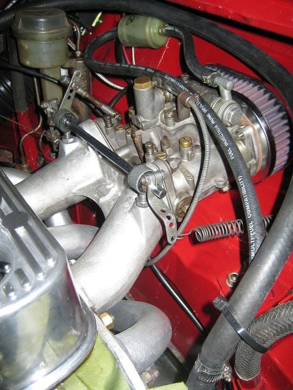

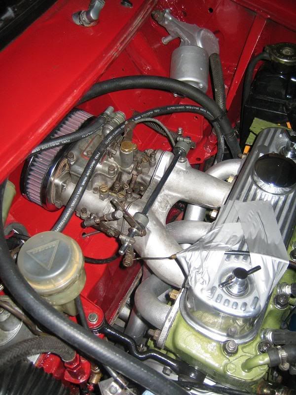

Like my makeshift accelerator cable bracket? :oops: Need to fix that asap...
She goes really good, although yesterday because I used a suspect ign cable she was missing abit. Also probably because I have 3 month old fuel in the tank too :oops:
