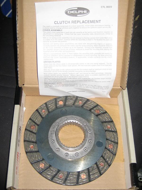

Clutch
I did manage to drop in at Karcraft on Friday morning to buy clutch parts and brake parts. I just wanted to touch briefly on clutch parts. I purchased a regular Borg Beck clutch plate which will be mated to a blue diaphram and my lightweight flywheel/backplate assembly.
Regular Borg Beck plate

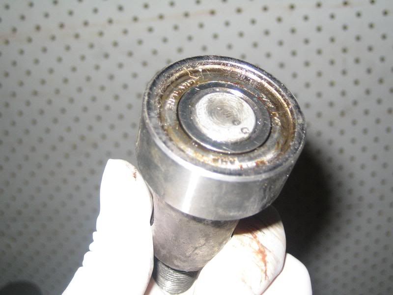

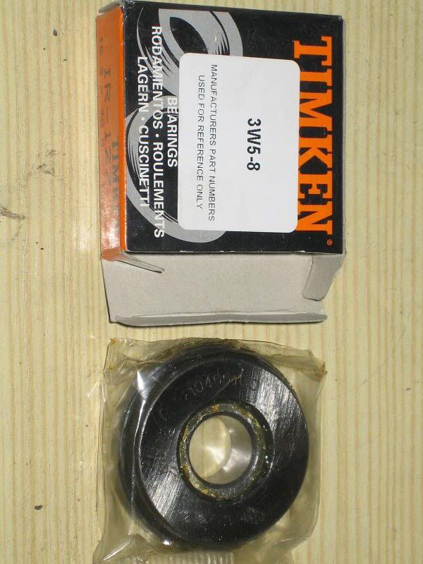

When I went to purchase the thrust bearings (sometimes known as a clutch release bearings) I discovered that there are 2 types. One being around the $25 mark and the other being $50 mark. Now logic says the more expensive unit has got to be better and it is no different in this case. How much better/different the $50 is compared to the $25 one is very surprising! The $50 is a Timkin brand "orginal design flat face" bearing and the other is well... thicker and does not have a big surface on the sides of the bearing.
Needless to say I purchased the Timkin brand. Both Graham and Kev agreed that this was the correct one to buy and the other one is well... not the right one :shock:
This is what was in the 1100S engine prior to strip down. Notice the thickness...
This is the Timkin one and the one I purchased. Although it's a bad shot, notice that it is considerably thinner than the above design, plus the there is more flat surface for the bearing/clutch to sit on.
Does someone who knows anything about this want to elaborate further?? :wink:

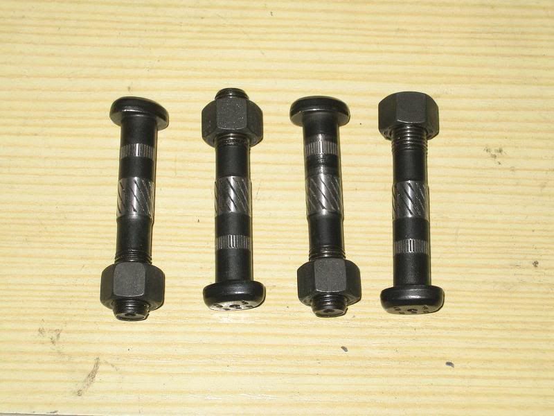

Ford Rod Bolts
This week our own Dr Mini managed to get my ford Rod Bolts machined down to fit the S conrods. They turned out great. This is what Matt (aka theminiman) uses on his 1400 strokers.
Ford rod bolts

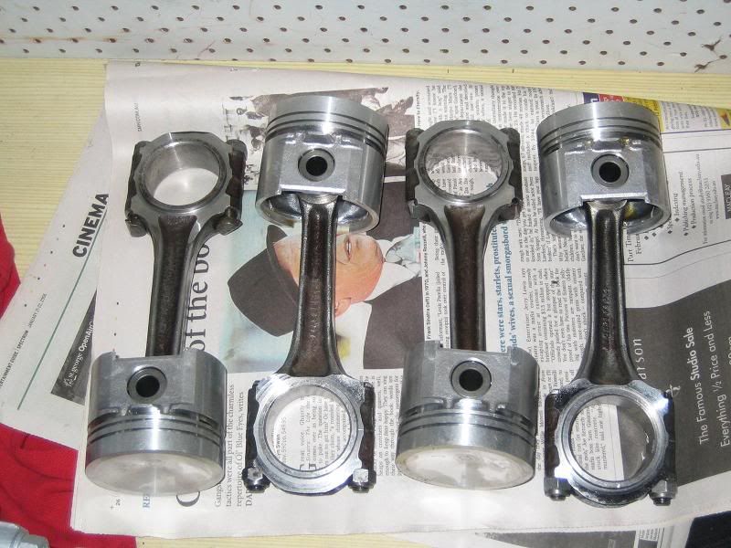

Although Graham was busy doing a few things for other customer's, he did manage to help me out with a few things this weekend.
Here is are the finished pistons fitted

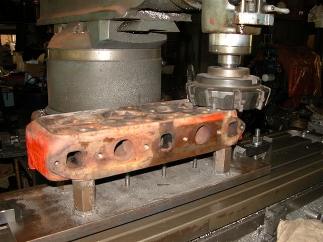

The Head
Graham set up the mill to shave a few thou to clean up the gasket surface so that it was flat.
Head being decked to clean and make sure the gasket surface is flat
The first pass did not clean up the bit between 2 and 3 as there had been a groove worn into that part of the head. So we had to do a second pass.

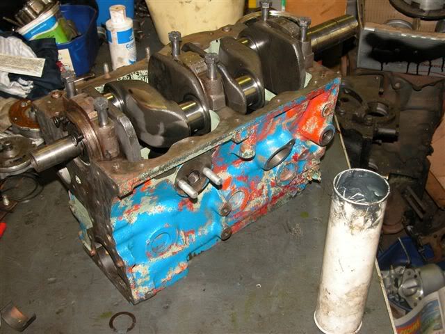

The block: Dry assembly
The block came out of the washer looking great and we proceeded to do a dry assembly to check the deck height of the pistons. Essentially it should either be flush or a few though below the deck. You then have insurance of the head gasket before the piston hits the head :shock: which is not a good look.
Dry assembly was done on the bench using the old bearings which were kept in good order. The crank was mounted onto the block and the caps tightenned down with the bolts.
Dry assembly was done just using plain engine oil as we did not torque down the bolts beyond hand tightness, and only for the center main.

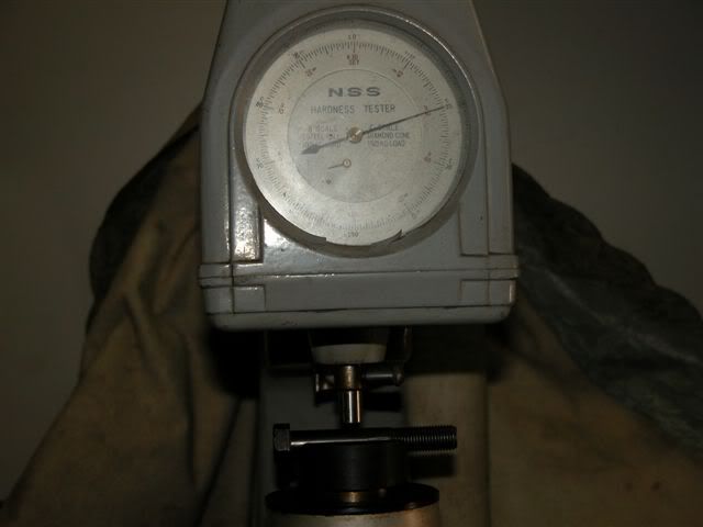

Graham called me this afternoon to tell me that he has discovered that most of the BMC standard bolts he has tested were all around the 20-26 RH range. This is no better than a Grade 5 bolt!!! Graham's theory is that during the hardness process when the bolts are taken out of the furnace and dipped into oil to flash cool them down, the bolts in the middle cool more slowly that the bolts on the outside of the strainer (remember we are talking about a strainer that contains thousands of bolts) and therefor that could explain the variance. That or all the bolts are 20RH :shock:
Rover bolt on Graham's hardness testing machine
Anyway this is all accademic apprently as Graham says it won't matter and just to use my new rover bolts...

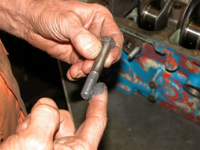

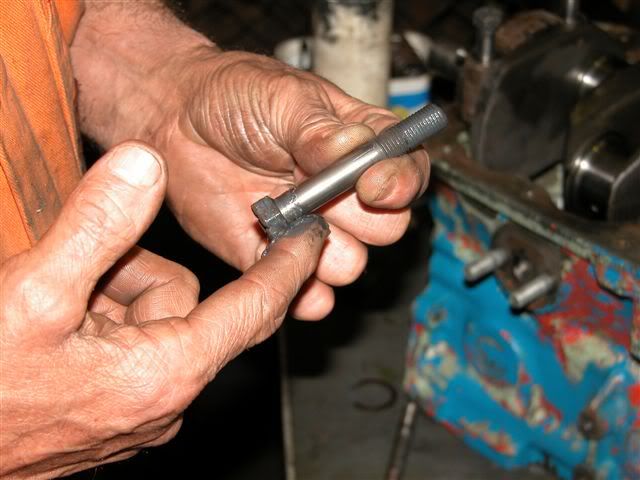

Correctly tightenning bolts
Graham also made me take notes on what do to when properly torquing down bolts for hgih torque applications such as mains cap bolts. Most importantly is NOT to use Loctite as the friction generated from high torque can set the Loctite and therefor give you wrong readings. The torque and bolt stetch is what holds the bolt down and Loctite is not necessary for high torque applications such as this.
The best thing to do is place abit of LMM grease on the thread...
And a little on under the head...
This ensures that there is enough lubrication to allow the bolts to torque down properly. This goes the same for rod bolts. ARP says to use grease on the thread to torque down conrod bolts.

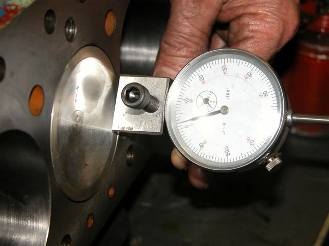

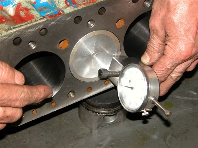

Checking deck height and Crank problem
Graham gently fit my rods connected to the hypertechs into the block and tightened the rod bolts onto the crank using the old big end bearings. We turned the crank so that the pistons was at top dead centre to measure the clearance.
This is how it is done with a dial gauge
2 thou below the deck!!! phew! 8)
It was at this point that we discovered that the crank was not turning properly. Every 180 degrees it would get hard to turn :shock: :( . Graham was like "uh oh" and at this stage I was near tears :lol:
Anyway it turns out the crank was 1) 0.005" thou total bent at the middle main bearing and 2) the middle main was several thou out of round :shock: Masterfully, Graham took to work using the hydraulic press to try to straighten the crank. Luckily this was an 1100S tufrided crank and this could be done with relative safety. Graham said if it had been a EN40B S crank it would simply break if we tried to use a press :shock:
Sure enough after a few tries, we Graham managed to straighten it to dead true. What a legend :lol: Else it would have been "find a new crank" for me as 5 thou is too much to even grind back to true.
The crank needs to be sent away to Spiro at Seven Hills to be ground to +020 on the mains. Dr Mini has taken it away... More updates on this next week.
