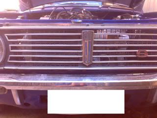

Here are a couple of crappy phone pics of the Bini blower mounted in the front of my Clubby they will not be the final brackets tho.
Thanks Nathan.

So it sucks in through the top drivers side and blows out the bottom into the FMIC then up to your previously built fuel injected throttle body set up correct? Where will you have your air filter/intake?
This is how I want to mount my SC14 but with out fuel injection and I'm also planing to use a crank sensor to get rid if the dizzy.
Where will your alternator go? My plan is to mount the SC low and have a small alternator above it or mount it at the back of the head.
Pretty much yes sucks in throw the oval section at the top, then out the bottom in to a right angle adapter to the front then the intercooler then up to the fire wall. But the old injection set up will only fit an SC12 as it was on the manifold from it. So for the time being it will be using a Metro Turbo HIF SU and Plenum. Then we will play with injection again down the track.
Most probably in the drivers wheel arch to stay away from the hot air from the intercooler but will have a guard to stop water and rocks hitting it.
If you look in the pic with just the bracket you can see that the alternator is lowered down as low as it will go before it hits the oil filter.
Hope that celars some things up :) Nathan.

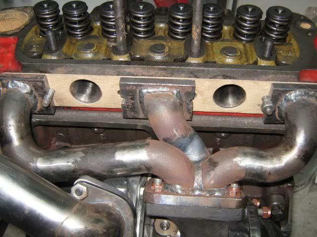

Just a question, why are the pipes on each side traveling down than across? It seems to me (from the angle of the pic) that you could have simply aimed them towards the turbo manifold inlet and save yourself some extra sharp turns. I know you need room for the inlet manifold for the head and you need access to the nuts/studs but it just looks like it could have been a smoother flow...

The exhaust manifold is like it is because
1 didn't have an inlet manifold yet to make it clear so plenty of room was left for it
and 2 the turbo is quite large so it is positioned in a spot on the back of the engine to give the most firewall clearance which means it sits a little high and the manifold has to point back up and these were the best bends achieved. It really isn't bad though.

I made up a turbo manifold not long ago , I angled the bends down and across also. I made it for easier access to all the bolts on the head.

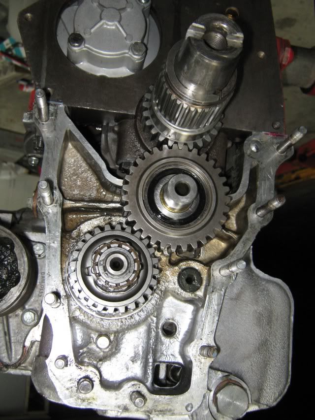

Drop gears – From Swiftune Straight cut with roller bearing idler, primary gear featuring bronze top hat bush and unique floating inner primary gear bush with retaining clip.
