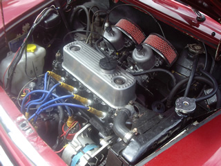

nice engine, wish mine was that clean lol, but yea i love drivin round the streets wit the accelleration, but not like it beats too many cars off the line lol. how much would it be to get that diff that you have?? coz i recently have been doin lotsa higway drivin n soon to be job will require higway drivin......been usin my girfriend's car as i thought that rpm would be hurtin the engine over long period of times....but yea how much to get that diff?
