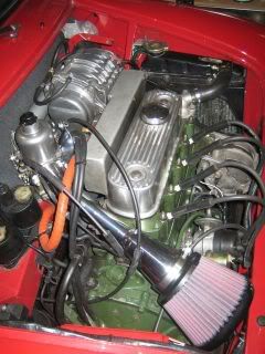

Sure, as stated is a 998 block out 40 thou & pocketed, RE13T cam, everything lightened & balanced, dbl valve springs, 12G202 head with 1275 valves, ported & polished, valves relieved... Running bens sc12 kit @ 8-10psi, and 1" 1/2 SU carb, MSD ignition, and some other money burning parts :wink:
Latest pic
ImageImage8)

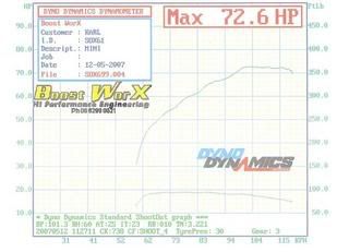

Results with this set up:
Currently head is off as am having issues with head gasket holding, so am building a 12G940 head to a similar spec as my 202. This means i can run a metro turbo gasket and they are also a little thicker, so i've been told, so they are less likely to warp.
Any other info u want just let me know & i'll see if i can help, need more 1100s on the road 8)
Carl

Sweet, thanks sox. I've seen that heaps and had no idea it was an 1100!! :o :D good work! Go the supa 1100! 8)
