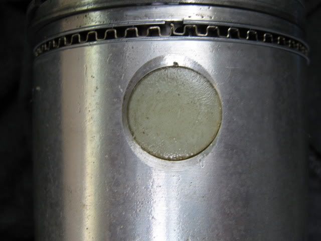

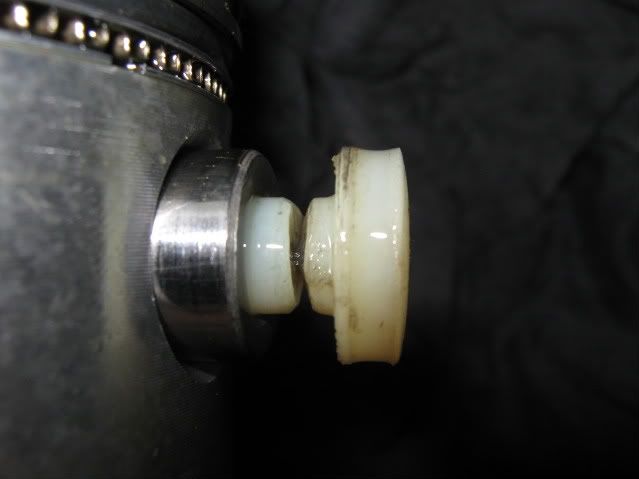

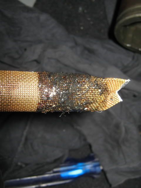

The Teflon buttons to replace cir-clips when new.
Image Image
The Teflon buttons after less then 100KM..

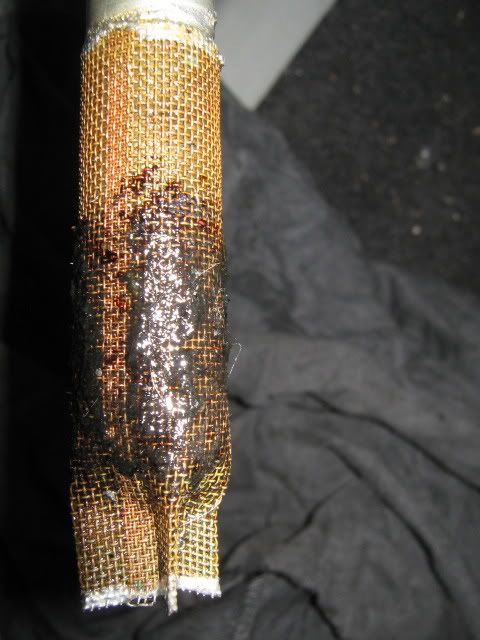

And then the oil pick-up.
But its all fixed and running really well NA with a Webber on it ATM, and will be doing a super sprint next weekend and if its all still working proply after that then all the turbo gear will go on :twisted:

what happened to the buttons? To be honest they didnt look like teflon? so back to circlips?
PostPosted: Sun Jun 27, 2010 11:13 am
Oh dear, worry, worry...
Posts: 692
Location: North Rocks
Hi SLO998
thoes buttons are made out of tivar not teflon, they claim it to be as good but it is no where near as good, teflon is a very bright white,(snow white)
make them out of that and you won't have a problem.
Graham Russell

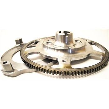

So the motor has been running really well with a weber on it, even started to run E85 fuel in it towards the end. It is out again ATM to change the dished pistons to flat tops to suit the new head :wink: Not that, that has gone quite to plane but nothing that cant be over come. The flywheel Has been changed to Swiftune's billet Feather Light Flywheel and Backplate and is just over a 1KG lighter again then what i was running in it.

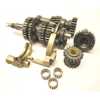

The gear box has always been a concern of mine given the power I hope to make with the motor, so this was next on the list to sort out. I don’t think anything better/stronger can be done now then what is in it :) Think Quaife from Swiftune 8)
Now just have to get it running and drivable for hay in under two weeks!

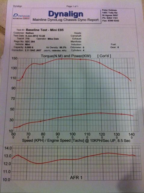

Ok so here is something else to show the project is still progressing all be it VERY slowly! The new dog box is in the car and is a lot of fun to drive. Finished hay without any problems to report. Very easy to get use to changing gear, but still feels like murder not using the clutch even tho it changes so easy! The 1st gear is very tall as we knew so is hard to get off the line slow and takes a bit of a launch and away you go :lol:

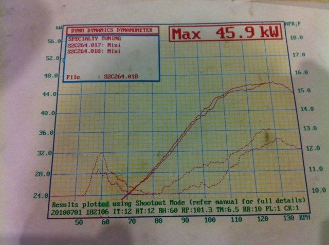

I think the car is making good power for a 998! Here is two dyno sheets, the first one was the 998 as it was built in this thread, the second is the re build to increase the comp by changing the pistons to flat top rather then the dished ones.
BP98 with 45mm weber and 9:1 comp.
The seconed one is how the car sits ATM.
re-rebuilt 998 + a little bit more then last time.., E85 with 40mm weber and 11.8:1 comp.
Peak power is almost the same but the low to mid is a lot more, lots nicer to drive.
