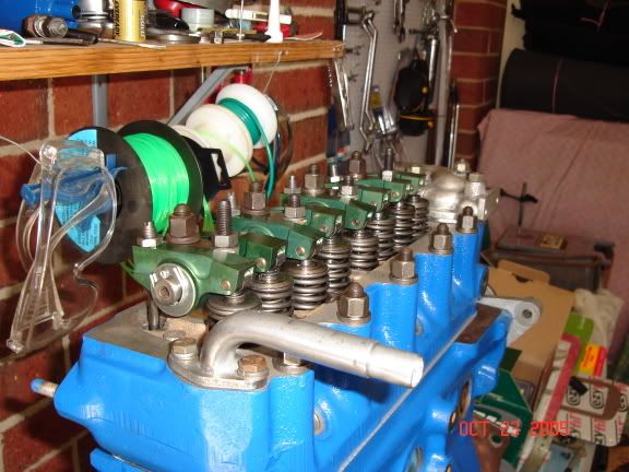

Here are some pics of my set-up. This is a 1018 so they are 1.3:1.
The cylinder head they sit on
I had 1.5:1 rockers on it and they kept breaking retainers...so I promptly removed them

PostPosted: Sat May 15, 2010 8:28 am
Posts: 1347
Location: Wellington,
Hi Rob
Did you make the rockers :lol:
Thanks
Kiwiinwgtn
PostPosted: Sat May 15, 2010 9:45 am
Posts: 2360
Location: SE QLD
Nah they are minispares items - I did i little of the headwork though(ports and the cleaning)
Rob Forsyth
Miniot!!
