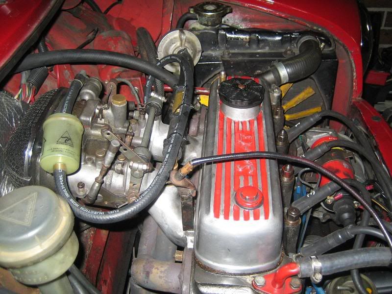

The current 1152cc in Lillee. Aint she a beauty :wink:
That there's a 45 Dellorto. Once you've gone sidedraft you can never turn back!

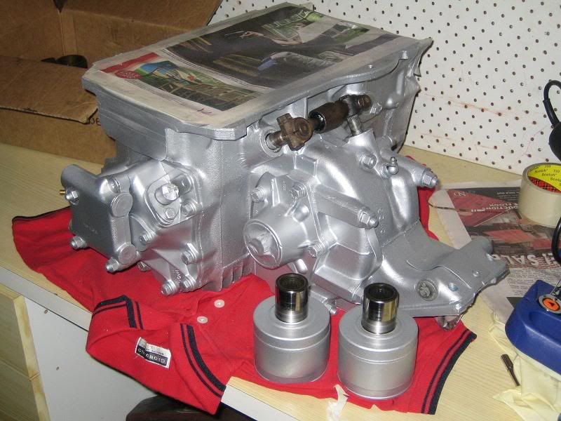

Kev and I have built a 12G1128 remote box from the ground up. It now has Mk 2 S ratios as I purchases a Mk2 S first motion and laygear from Minispares when I was there last year. Just touching on the gearbox: a whole kit has been through the box with all new bearings, a DR MINI Special Tuning rebushed mainshaft, MG heritage layshaft and a centre oil pickup. The diff has new heavy duty pin and new planet gears. The diff has also had DR MINI Special Tuning mods to accept an A+ diff thrust washers (with that little tab so the planet gear doesn't grab it and spin it). All new gaskets have been put in and it is now painted in silver engine enamel and sitting on my bench in a dust free wrap :wink:

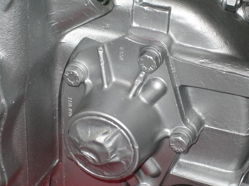

Picture of my Mk2 S box with pot joints
Dr Mini Special Tuning modified pot joint side covers :wink: (hint chunk off the top)

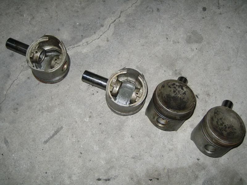

I used this cool hydraulic press to push each pin out of the old pistons to disconnect the rods from the old stock pistons. Way cool 8)

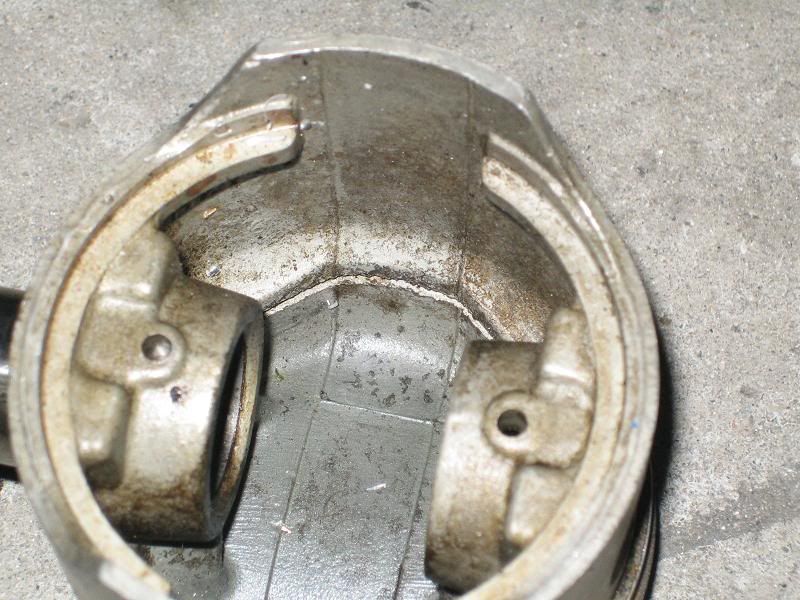

Old pistons
See the slot that runs horizontally? Graham says this is why they break when revved hard. The slot is HUGE, like half the diameter of the piston on both sides :shock:

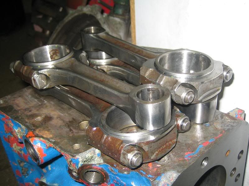

I then started balancing my S rods myself (under the guidance of Graham) on the belt sander. I've never done this before so it was quite fun! He gave me some pointers and off I went! After about 2 hours I now know how much effort goes into this type of work!!! I compare my 2 hours of work to what Graham has done for a Nb racer and I am shocked! :lol: The aim is to make them all the same weight. The theory is if engine internals are light, the engine can spin more freely and there is less load. Vizard talks about this in his book :wink:
Graham also took alot off the sides of the big ends and I have rounded off the small end and taken most off the sides of the rod. They have come up quite bling even if I do say so myself 8) On these I will use Ford rod bolts that will require mofication. Kev says this is a good mod as the Ford bolts are 16 for about the same price (or less!) as 8 S ones and are very good. Hey if they can hold a Ford V8 200+hp engine together why not a mini with 100hp :wink:

I actually had a question from someone this week as to what I did to prepare the gearbox in the previous post. Well all I can say is a lot of hard work :lol: To get 35yrs of gunk off your parts, diesel is your friend! I have a diesel bath set up and dipped the gearbox and other parts in there for a long time (say about 2-3 weeks). Once that was out of the bath I used a combination of Supercheap Auto $2 degreaser, water, wire brushes and compressed air. There was alot of sludge in the smaller places so do look for that.
To paint it, i just rubbed it over with metho to, used white knight enamel metal etch as the first 2 coats. Note that there are more than 1 type of metal etch, some will say aluminium and some won't so read the label. Top coat was just white knight engine enamel silver, 2 coats.

Rods

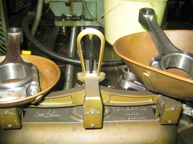

This week I also spent more time on the rods. This time i spent time cleaning them down so that they are all balanced right down to within a gram using Grahams very accurate scales. I also spent some time filing down the sharp edges near the head of the bolt on the rod as this is apparently where cracks start. All in all I am very happy with the outcome and I suppose if they break I only have myself to blame!!! :wink:
Can't get more balanced than balanced!
This is the final product

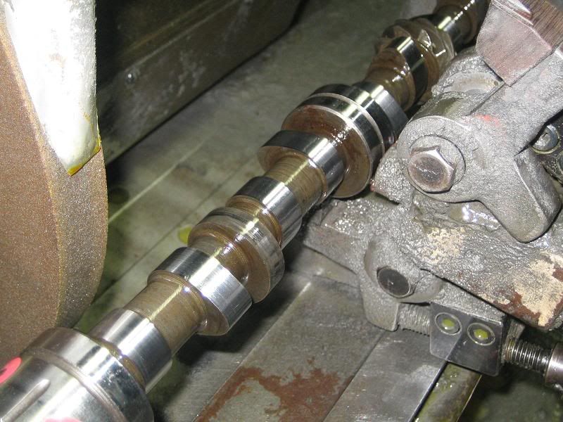

Cam
Graham also has been quite busy grinding my spider drive cam into an RE13. This should give my build the right amount of power and pickup mid range. I am very looking forward to putting it in now that I have seen the final product!
A very bling virgin grind RE13 spider drive cam
Check out that finish! Bling you can't see! :wink:

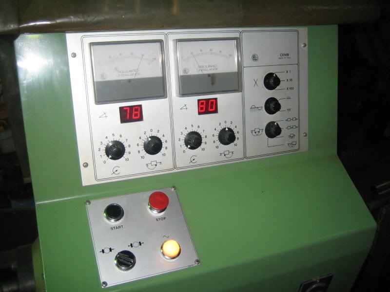

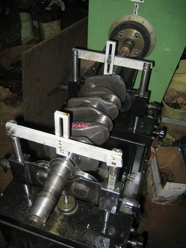

Crank
Graham also completed the balancing of the crank. Graham noted that the crank has had quite a fair bit taken off one of the lobes from the factory. This was due to perhaps casting faults at the factory and back then they didn't care where they took metal off, just so long as it was balanced. Well according to Graham's machine it was way off.
Those two dials at the top should be near zero
Crank on the balancing machine. Actually it is spinning here in the picture but the flash on the camera makes it look like it's still! you can even read my name on it!
After a fair bit of work, as alot had to be taken off to balance it, it was reading zero on the machine on the finest setting. Masterful work Graham!
