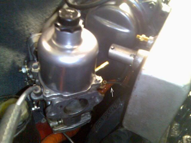

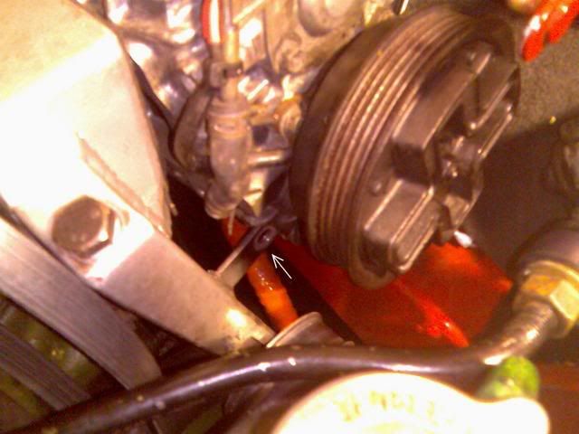

I know from experience that it can be a little difficult to get this kit in/out of your mini. The main areas i had difficulty in accessing were the manifold bolts and attaching the inlet pipe to the rear of the supercharger.
I was told about a different method so thought i'd share it.....
n.b. Pics off mobile so a little fuzzy!
Look for my arrows in white->
1) First thing, remove engine steadys & inlet pipe from in front of SU. Remove Supercharger belt, boost gauge line, fuel line, accelerator cable & choke cable (if possible).

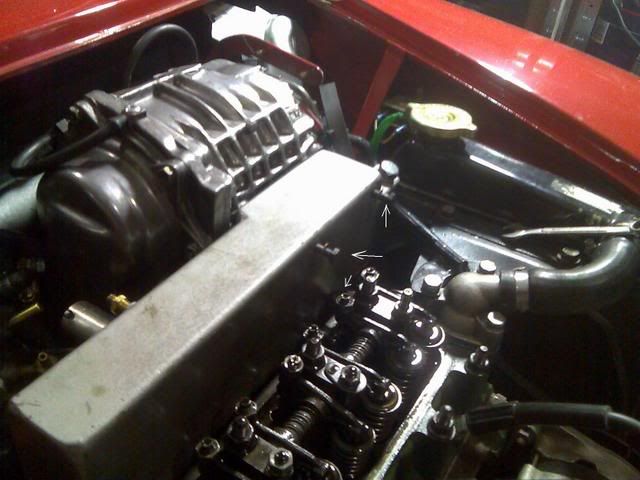

2) You can now undo the 10mm bolts pictured below.
3) Undo 17mm nut below supercharger & remove large supporting bolt.

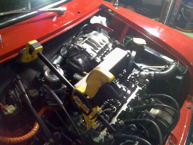

4)I then use a 'quickgrip' to give the motor a slight push forward.

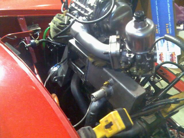

5)This should now give you enough room to pull the supercharger, inlet pipe & SU out all in one go!!!
I used this method and found it sooooooooo much easier.
If your keen, this should take no more than 15-20 mins & look something like this:
Look at all that room to get to the manifold bolts!!! :D
Carl

Hey I like that.
I did it, manifold, then charger, then carby, attached to short manifold. So that's three steps. But the quick grips would make it even easier!
Mine came on and off about 5 times, so by the end I got good at it, especially the carby part.
Glad you took pics, should make it a sticky, as I've been PM'd about this quite a few times. And keep answering the same question. Since you did such a good job of showing everyone and taking good pics.....

As for my gear change, i don't have a magic wand... it's a remote with linkages etc. & i manage to get the clearance without damaging or bending anything.
One thing i forgot to mention is to remove the bottom bolt from the extractors to gearbox support. Without this removed it won't tilt at all. Also put the bolts through the inlet first, as they are so long, they won't clear the rockers.
As far as drilling a hole in the firewall, thought about it... A removable panel?? If i ever take the blower out i don't want some massive panel visible, plus that then means i have to pull interior pieces out each time.Too much work, this is easier IMO.
Before i was putting the inlet & supercharger on together, then the carby & rear inlet pipe as one. Many different ways of doing it, i just found this to be the best for my set up. :wink:
