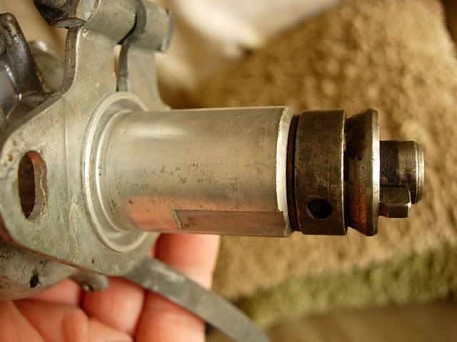

Putting back in the distributor and thought there may be an O ring or seal on the shaft. Couldn't find one and may have not had one when taken out. Some diagrams I have found indicate there should be O ring or seal somewhere on the shaft.
Does this look correct?
Dave K.
PostPosted: Thu Jul 09, 2009 3:52 pm
Looks right to me. No spot there for an O-ring, so don't sweat it. :wink:
PostPosted: Fri Jul 10, 2009 9:31 am
Posts: 281
Looks as if the scolloped out bit just under the bracket might be for an 'O' ring?
PostPosted: Fri Jul 10, 2009 4:28 pm
No they never had one there. That spot under the flange is to break the dizzy flange if you overtighten the clamp or have a prang. Lucas `planned obsolescence...' :lol:
