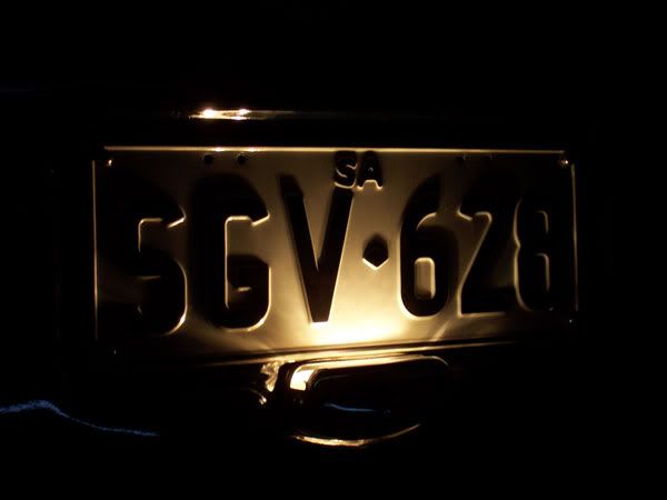

Ok over the years/days/minutes, there have been questions about the numberplate flap removal.
So I thought i'd How to it.
1. Ok so we start by unscrewing the plate from the flap.
2. Underneath the flap there should be 6 countersunk bolts.
3. Locate and loosen these.
4. Trace and unplug the wires leading to the numberplate light.
5. Remove bolts that hold flap hinges and remove flap.
6. The area underneath the hinge on the body may have a small amount of surface rust- in this case (like mine), dust it off and mask and spray with black or whatever you have on your shelves.
7. Once dry, bring numberplate up to the body recess and mark out for holes to be drilled. Measure twice, drill once! Be careful at this stage- dont slip!
8. Drill the holes and put some nail polish around the bare metal edges so it doesnt rust out later on.
9. Attach numberplate to body- I used 316 grade stainless steel bolts and acorn nut thingos- see the pics.
10. Mark out holes for number plate light and drill these holes.
11. Re-route wiring through another hole in the boot lid for the numberplate hole or use an existing one.
12. Check that the light still works and step back and admire your work.
A very easy job, isnt it?
Comments on the pics appreciated too :)
edit: pic links were buggered.

nice tidy work willy.. half the time the toughest part is haveing the guts to have a go yourself... great result too

Nice job on the plate flap. You should have put rubber spacers between the numberplate and bootlid though. Not only will it vibrate/rattle with your sub, but dirt and leaves and crap WILL get stuck behind it - might scratch the paint behind/around the number plate. Just a thought.
It really does make the back of the car look less busy, doesnt it! 8)
