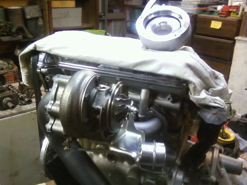

sorting out the orientation of all the various inlet, exhaust & center bearing housings to place the turbo in exactly the right spot,,, not much room inside a mini engine bay so this part is sooper-dooper important to get it right before fitting the engine into the hole--->

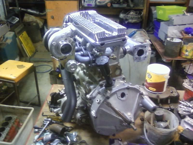

This shot shows all that sorted & mounted now,,, & the waste-gate diaphram & acctuator is also arranged & mounted,,, also the inlet plenum/manifold almost finished,,, lots of pollishing been going on too :-) --->

How much room is there between the exhaust pipe (looks like a very large bore) and the drive shafts or do you use hardy spicers?
What size turbo are you using Matt?
Got any photos of the front with the intake plenum?
Thanks.

Is that the 16V head Matt?
I like the oil filler!
8)

here`s a pic of quite a few of the turbo & N/A manifolds/extractors & their Jigs that we had made, & some of the plenum chambers/inlet manifolds we make
it`s a very old pic tho & these days we have "refined" a few things along the way so they`re looking even "Prettier" & working far better now too
this one is an 8V
turbo is a Garrett GT2560Rs ball bearing jobby good for well over 200Hp (if you want to go that hard that is) very mild, no lag , smooth as a babies bottom :-) check out the Blue Moke in mini Experience magazine,,, same set up except it`s 16v
plenty of room for the dump pipe to inner pot or hardy spicers,,, no dramas,,, that`s why we Jig all the pipes
& Marc i wish it were yours, cause that would mean you owe me about $17,500 :-)

What sort of clearance is there with the bulkhead to turbo?

Hanra,,, no clearance issues at all to the bulk head, plenty of room (well enough anyways)
