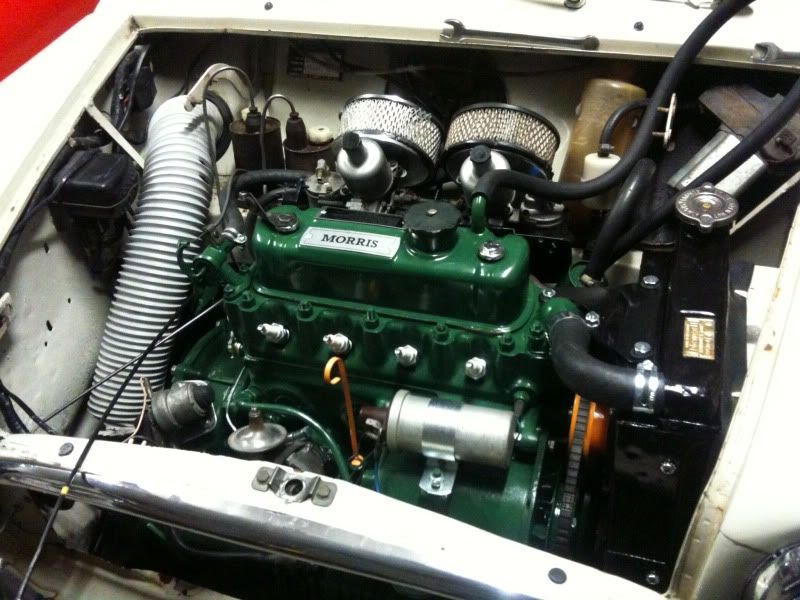

Doc, I've got these type:
(Picture 'borrowed' from Mick! :P )
I'm doing a bit of maintenance, might take the head off and clean up valves etc. Treat it to a new BK450 etc.
Want to be sure it makes it to Wakefield! :lol:
