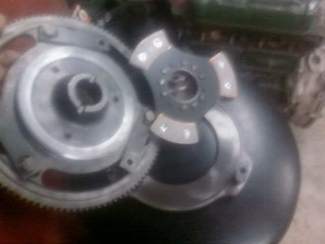

PostPosted: Fri Jun 24, 2011 3:47 pm
we do a nice light package, but using a "Blue" diaph,,, gives over 1200-1400lbs clamp (depending) pressure & still fairly light on the foot
Now that pic shows it with a puck plate but a decent AP comp material plate will be fine
if you notice we use our own CNC lightened (2-piece) flywheel, but we machine & press fit a new clutch spring "seat ring" into the flywheel, which moves the spring pivot point to effect WAY more clamp-age using the blue diaph , without the problem of being heavy on the foot
pretty tricky hey? :-)
Edit--> Vertos are heavy as lead,,, no matter what you do to them & besides they`re for skinny little girls :-)
