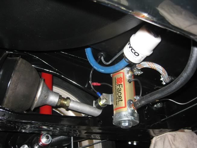

Facet pump info-...
http://www.facet-purolator.com/cube-fuel-pumps.php
re the mounting, I used a centre exhaust mount (the big rubber block). Pump holes are same spacing as it has. Just 1 hole to drill in the subframe web.
Note wiring shown was unfinished.

I have a silver top pump and malpassi regulator, mounted the pump on subframe under the fuel tank and regulator in the engine bay near the wiper motor.
