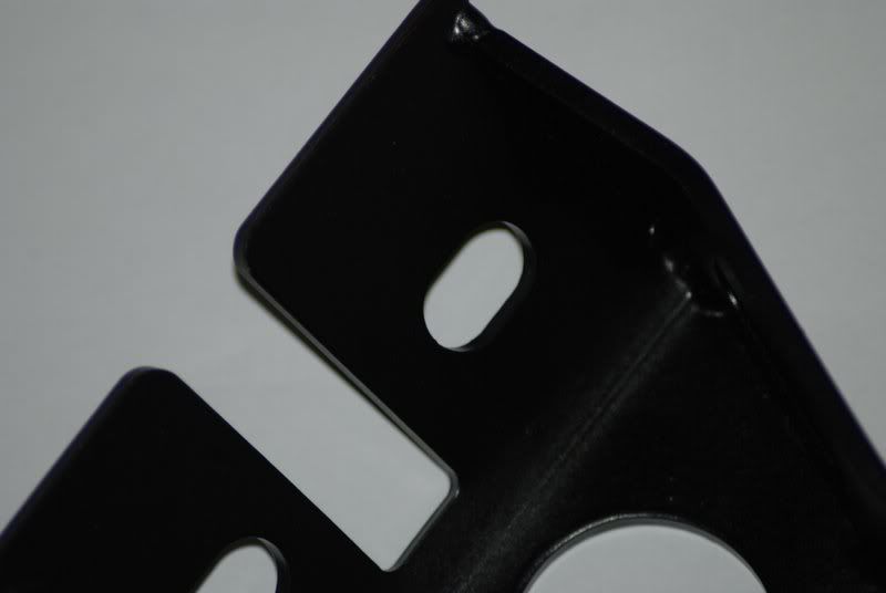

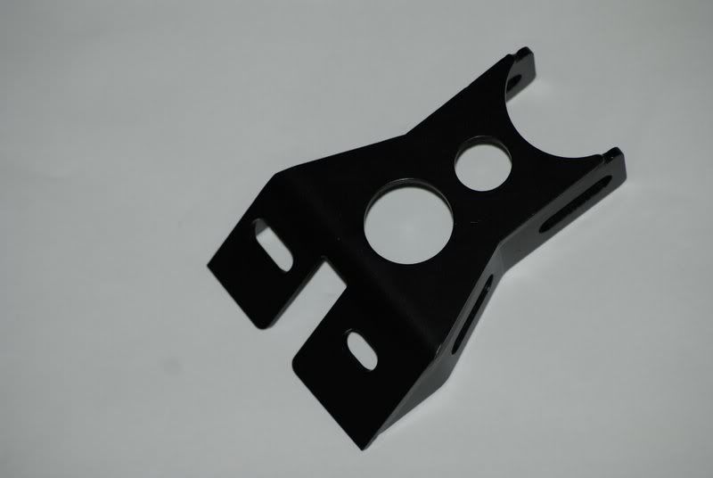

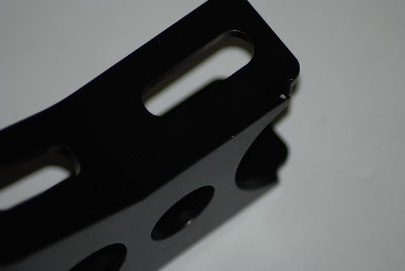

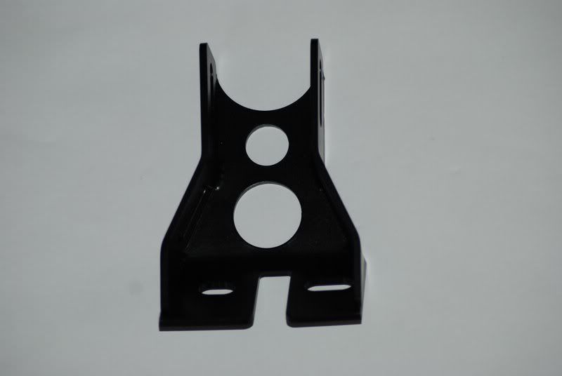

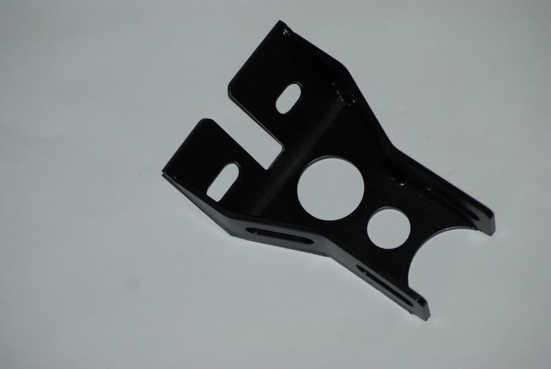

I used to have one of those but it kind of looked a bit flimsy considering that this is what the column pivots around in a frontal collision. If it snaps instead, then the column and wheel is likely to head straight for your face.
Now my face might not be the best looking one around, but its the only one I have, so I upgraded to this one made by one of the blokes on the UK Mk1 forum.

Hey that looks pretty nice, mick. Got more details on how to get one?

tomkidd on mk1 performance forums was the guy who had them made.
It looks like he sold his last one in June.
If enough people pester him, he will have another batch made I think.
They came powdercoated black or nickel plated, in standard length and longer than standard.
25 quid posted to NL if i recall (it was 2009!)

A bloke on www.theminiforum.co.uk has recently started selling a similar design, in two sizes. First is apparently the same drop as the silver one in your original post, the second drops it a further 30mm. I can't comment on the respective qualities but they are similar in appearance to the Kiddspeed item that mickmini posted, although note the circular vs trapezium cutout on top and the slot cutout for fixing the steering column angle vs the 3 pairs of holes for same.
That said, I'm thinking of ordering one. Also makes a harness bar, seat rails, etc if you're into that kind of thing. See JB Fabrication on Facebook for more pics and information.
