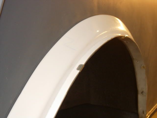

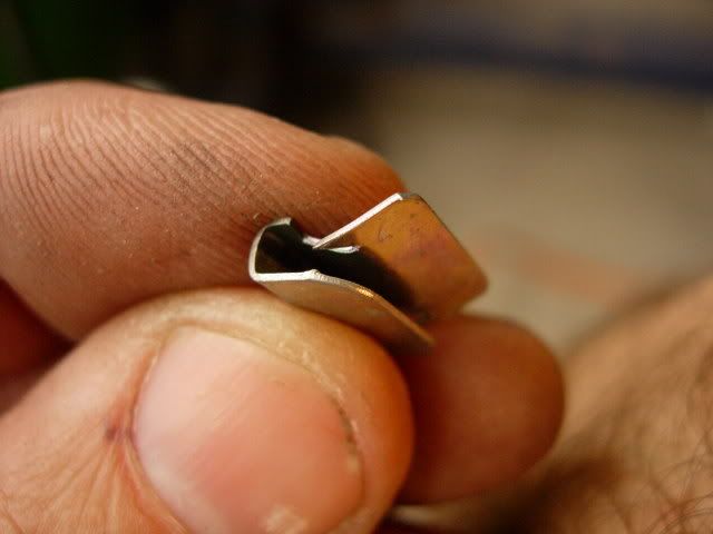

The clips are available also via ebay from John:
http://cgi.ebay.com.au/COOPER-S-AND-MIN ... 240%3A1318
Dave K.
PostPosted: Fri Mar 27, 2009 8:22 am
Joined: Thu May 04, 2006 10:49 pm
Posts: 67
Location: Santa Rosa, CA USA
Thanks for the photos Dave. Are there two different clips we are talking about though - 1 for the arch to the metal arch form and one to hold on the chrome plastic trim to the arches and lower seams?
I can see how the one pictured holds on the arch, but there are no barbs on that clip to hold the trim on to it. I think I actually have some of those clips that I got from Mini Automotive a few years ago, but they wouldn't hold the deluxe trim on.
Craig
PostPosted: Fri Mar 27, 2009 1:37 pm
I think the outer edge of the clip is fat enough that the trim grips it
