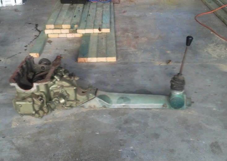

PostPosted: Sat Jun 04, 2011 9:30 pm
Posts: 3135
This is the gearbox 22G1128 with a gear change "attached".
Is that a pudding stirrer or rod change?
I did a recount of the teeth on the diff and 17 / 64 is correct.
Sorry about the awful photo
