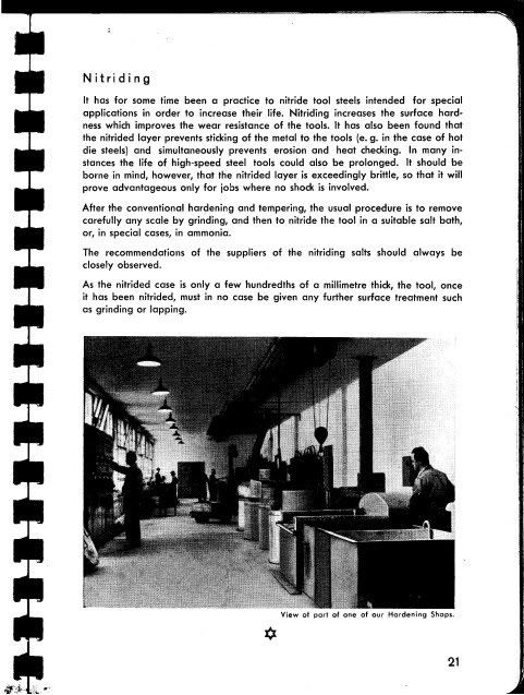

For anyone who's interested, this is a page I scanned from the Bohler Tool Steels book on Heat Treatment. Its only brief. But its a publication, as in not something that someones writen up and posted to wikipedia. This was writen by metallurgy department of Bohler Tool Steels.

FFS..the internet is full of PUBLISHED disinformation and half truths subsequently disproved and improved...grow up stooopid :idea:

PK, that Bohler blurb is all about salt bath nitriding, which is nothing like proper gas nitriding (using ammonia) as used on EN40B..
go google gas nitriding... :wink:
eg here- http://www.keytometals.com/articles/art132.htm

Doc,
As I pointed out to you last time on the topic of nitirding.... salt bath nitriding IS proper nitriding. Gas nitriding is another type. As is Plasma.
Further more,, and Kevin, I think you know that I have no grype with you so please don't read into this the wrong way... but... TO YOU AND EVERYONE ELSE PLEASE BLOODY READ IT
It says right there in the second paragraph IN SPECIAL CASES AMMONIA... It's a general "blub" about nitriding. What it says is relevent to all types.
"Google" Ammonia nitriding and see what comes up.

EN40B cranks are NOT, repeat NOT nitrided in a salt bath... :wink:
We are not making press tools here.
Read down that page where it mentions about compressive stress.
BTW guys I am NOT defending anybody here, but gas nitriding is THE process used on EN40B cranks.

The process and effect (be it gas, plasma, saltbath) is still the same whether you're making a "press tool" a crankshaft, or just a very hard wear resistant paper weight.
Where on the page does it say "salt bathing only"? In the same sentence that mentions salt bathing it says "....salt bath or in special cases ammonia"
I don't follow you, are you refering to Mowogs post or mine? The page I put up doesn't mention compressive stress anywhere :shock:
