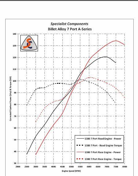

This is the dyno sheet from Specialty Components 7 port (on a proper engine dyno not converted drive on)
This is a CNC machined billet alloy head.
People we asking for dyno figures on some of these 7 ports.
Graham Russell

[quote="GR"]Hi All,
Graham Russell
Hi Grahame. You're looking well!
Aren't you getting close to the same power from your 5 port big bores?

Bling does not always = HP. 8)

Hi Giddyup
I'm getting a lot more torque and HP than that from the 5 port motors.
Graham Russell
100ft/lbs (barely and not for very long) is rather disapointing...

Those figures mean nothing to the owners of the heads that we have bought. We have different cylinder heads to the billet Specialty Components 7 port shown in GRs dyno sheet.
Can't wait for dyno results on our el cheapo 7 port heads.

As you would all surely know we really can't compare Dyno results taken in the UK with dyno results here in Oz. There is only one way to use dyno results that would mean anything to anyone;
Same dyno,
Same engine (just change the heads, same comp ratio) as Vizard would to prove worth,
Same day,
Same weather,
Apples with apples

Yah not really sure of the value of the comparison up top. Compare an 'as cast' 7 port to a 5 port that's been prepared by a guy with 4.7 bajillion hours experience doing just that :wink:
Sounds like there will be a few of these around, so will good to see what they can do once people have a bit of experience preparing them.
