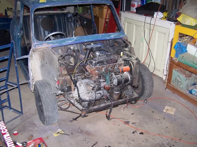

heres some pics from today,
i have worked out all the mounts i want to use
2 picesof angle welded to the seam pices on the inside, which will have a striop of rubber between them and 2 bolts, thats on both sides by the a panels.
then i will use the standard subframe mounts down the bottom, modified a we bit and a hook added!
heres my old bung front, anyone want it??? its yours or scrap.
my sexc new rover front, cheers steve, nice doing business with you.
got a rover grille and bonnet too to finish it off!
and this is what happens when u leave me witha angle grinder!
so i will start fitting in the near future,
man my motor is ugly, needs a clean and paint 8)
