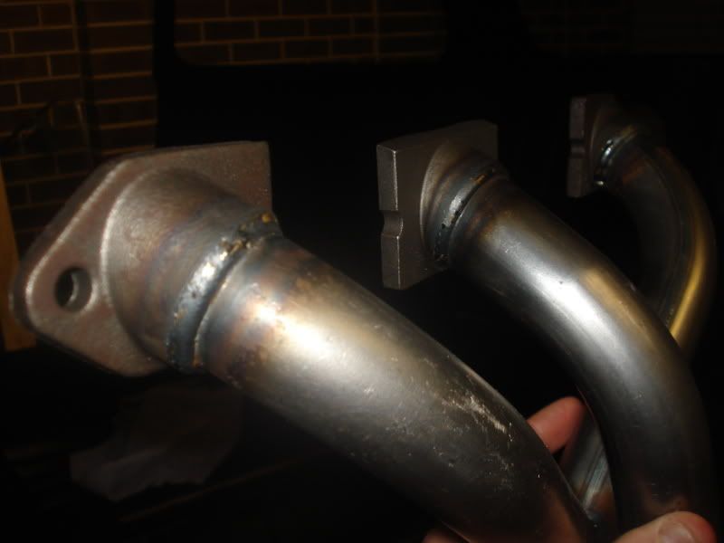

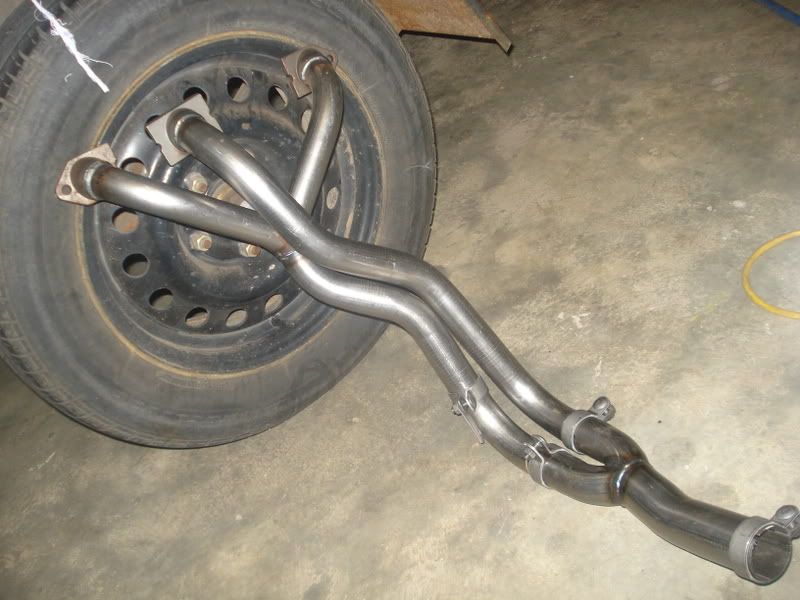

Mick wrote:
BALLISTIC wrote:
Maniflow LCB extractors into either a 1 3/4" or 2" pipe to a "hot dog" 1 3/4 or 2" exit.......sounds quite good i think and works very well! stainless is nice but it depends on your budget.
The chinese copies of the maniflow are very nice as well if you want to save a few dollars.
Are they the same `quality'- ie. are the flanges bent like on all the Maniflow ones? :P A pity they never have made them flat after the welding distorts them.:x
I've run two sets now and vouch that they are great value. The ends are cast steel and nicely welded onto the pipe. No sealing issues at all, and MASSIVE ports as well. They are three piece and come with the steel clamps around each and every join. Center pipe is a larger gauge than the two side pipes. They keep a nice finish over time as well. Approx 220 - 245 depending where you go.
The only down side I have noticed is that the massive center flange needs to be ground down a little on the top to clear twin SU cross pipes. It would be no problem on just about any other manifold. Saying that, it only took two minutes with a grinder before fitting the manifold onto the engine. Maniflows look to have the same problem as well.
My mileage isn't as high as some, so anyone who's had any cracking or other issues with these pipes please speak up before I send someone down the tube :) My view is that they seem very good for the money. They make a nice noise with 1 /34" and a side exit RC40. Ask Davo111 :)
