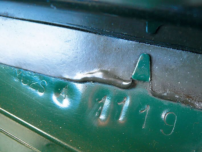

You mean like this? :wink:
Watto. :shock:

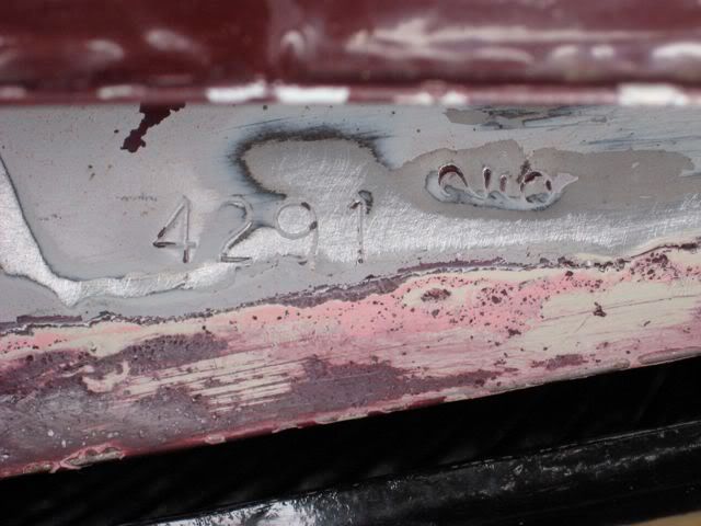

Or this Mk1...

Those numbers on my 79 Moke looked like the guy was leaning drunk when he stamped it- could hardly read the tops of all the letters. :lol:

No that green one is Mk2 and that would be by hand. Mine is like Morris 1100's post.
Like this....
...although the YG2S on the green one looks to be stamped using the same method as the earlier body no.

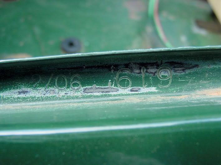

Didn't Mk2's have the body No. (500 less approx) in the bonnet gutter? What do these numbers look like?

The number on that green Mk2 (1969) is as all of the period I have seen. The YG2S is clearly one stamp. The 4 is a separate stamp, and would be replaced by a 1 or a 3 depending on the model. The rest of the chassis number is made up of four individual stampings.
The two Mk1 cowls shown look neater, but the gaps are still a little uneven and the horizontal alignment is not perfect, so I would question if they were done in one stamp or by a machine.
Yes, the 1969 cars had the body number in the rain channel. It had the M2/06 stamped one way, and the body number, 619, stamped from the opposite side. Of course 619 would look much the same from above or below, except the 1 is one-directional and is clearly up-side-down compared with the M2/06 (photo taken from the windscreen side).
