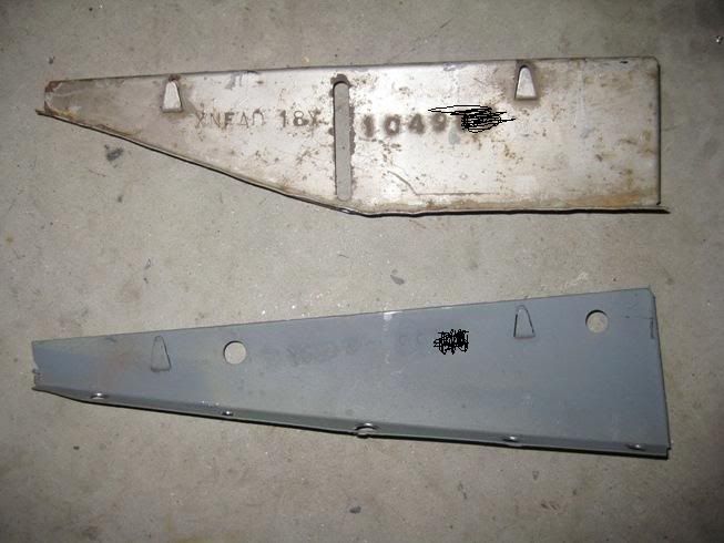

It is a 69 Mini K. YG2S1.
PostPosted: Tue Sep 14, 2010 7:36 pm
Posts: 3415
Location: Cowra

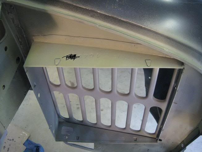

Michael i reckon just swap the radiator shroud with your clubman one. Save a lot of hassels. The person doing the blueslip wont know its not the original inner guard. And it is representing the car for what it really is, an LS
Goodluck
Brenton
PostPosted: Tue Sep 14, 2010 7:38 pm
It's not that easy, they are a different shape.
PostPosted: Tue Sep 14, 2010 9:50 pm
Posts: 3166
Once again you are correct.
Well an update is that I have removed both top panels and am now cleaning up the Clubbie panel ready to reshape and weld back into place tommorrow.
So all good.
Car keeps its original number and should therefore make the registration process easier and the Mini K has been placed into the dead Mini K register.

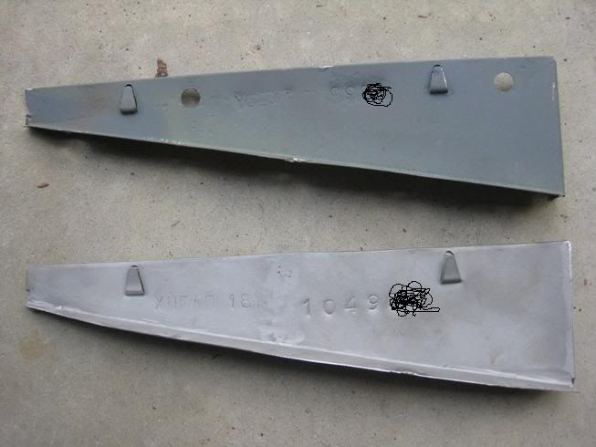

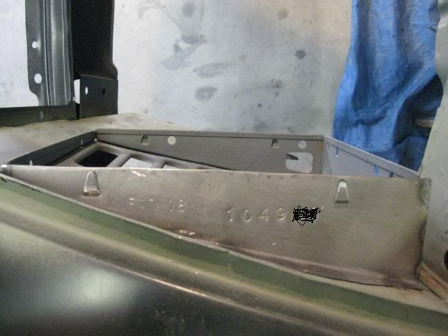

PostPosted: Wed Sep 15, 2010 9:02 pm
Posts: 3166
Well I have done the deed. :)
First I reshaped the Clubman panel to the shape of a round nose.
Then welded it into place
Ground down the welds and finished with primer.
Probably would have been much quicker and easier prior to fitting the inner panel to the car.
So another job finished.
