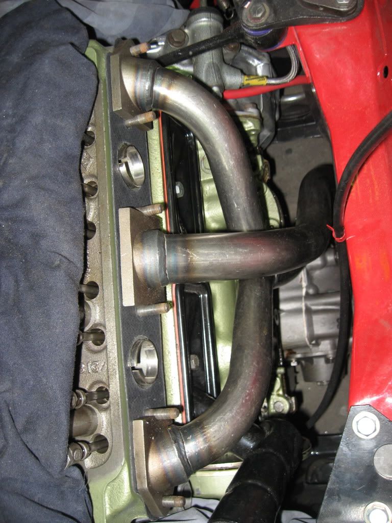

miniDave wrote:
dalmeny wrote:
2. The cover plates over the push rods, fitted with cork caskets and good sealant were leaking oil down the back of the engine. I had them a nice snug tight, but obviously not tight enough. Can you tighten the bejessus out of those cork gaskets??????
If your covers are the ones that rise outwards with the bolt on the peak then you need to seal around the bolt head. There is a rubber/felt washer as new but I put some RTV Grey gasket maker under the bolt head and the leak stopped.
Agree also with the suggestion that unless the engine breathing is set up properly it will blow oil. Can't see a PCV set up in that rocker cover. I have the same cover that I put a BSB thread and 90 degree angle output and plumbed it in with a toyota PCV (under advice from DrMini) to the manifold.
Dave, any chance you could throw up a photo of your set-up for the PCV.
P.S. So the hole in the top of the cap and the breather tube attached to the rear cover doesn't stand for much?

As you can see I have a breather on the right near the radiator , my rocker cover is vented straight out , my engine is a factory standard bore 1100, factory cam but with a higher compression ( about 9:2 or 9:3.1 )with the change of head , I have no real need for another breather as the crankcase pressure even with hard use is about static , from what you are describing I would say that you need two breathers to reduce the crankcase pressure

my understanding with cork gaskets, rod covers and rocker cover alike, they should only be done up firmly. Too tight will squash them and cause leaks, if not deform the covers
Sounds as if as described you might need another breather because of excess pressure

Did you change the square o-rings on those 2 bolts-- the late covers like these are more likely to leak there than the gasket.
The right gaskets for these late covers are NOT cork, they are red silicone rubber- used on Cooper S and 998 Clubby.
The cork and cork/rubber gaskets are for the early flat face covers only (size is different).

I cleaned it up and took it for another run and it looks like the oil is being sprayed out of the squashed breather pipe in the rear cover plate. Do I need to put the original tappet cover on and feed a hung of hose down towards the road or do I drill the alloy cover and fit a PCV and run it into the manifold. Does it have to be balanced between the two inlets, or can it just tap into the one side of the inlet?
If there is a thread on here about the set up can you let me known.
and check that they haven't been over torqued at some stage and the rise is squashed or no more...check that the flat sections around the rim are flat against the block (before you put the gasket on)
