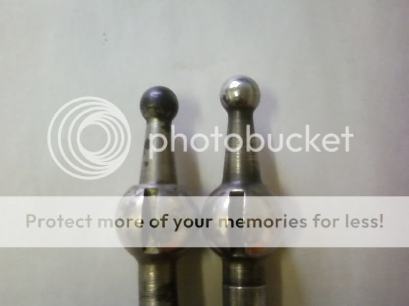

if you have a magic wand gear stick they drop straight in the remote box,
shave the bush (see below) the then cut the stick to a desired height, tap a thread on it, voila shorter throw stick
because the stick is so long it has a shorter throw to compensate for the length
get the two sticks with the bushes on the bottom stand them up on a flat surface and note the height difference, trim the bottom of the "wand bush" so that the large spheres are the same height
i polished mine while i had it out, alot of sanding

the difference of the sticks is only 3 or 4mm
but i did some rough maths on the sticks with a ruler and some butchers paper
after pivoting both sticks on an axis moving the lower ball 1cm and measured the travel of each stick 30cm from the pivot
stock stick travel was 7.6cm
the wandtype was 6.4cm
so at 30cm height above pivot (where the gearknob is) the travel was reduced 1.2cm per 1cm of lower ball travel
i would measure the travel between first and second but my bushes are worn and that travel would differ for all you guys
