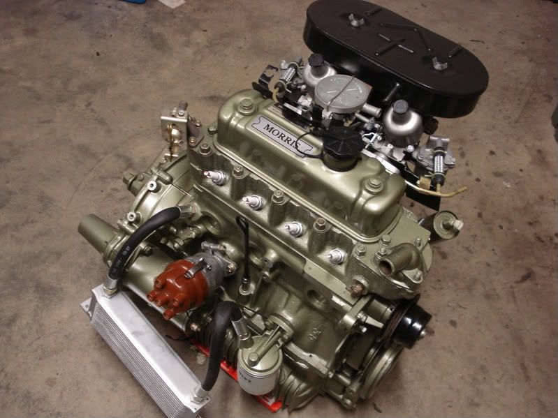

and... here's a comparison vid I just made :-)
Short-shifting on the last one as the car is yet to be tuned so I'm not revving the buttocks off it :P
As mentioned in previous posts, the last vid is not a direct comparison as the head work / cam make a big difference to the sound and performance. How good does it sound though!! hehehehe
http://www.flickr.com/photos/chux007/12337206304/
