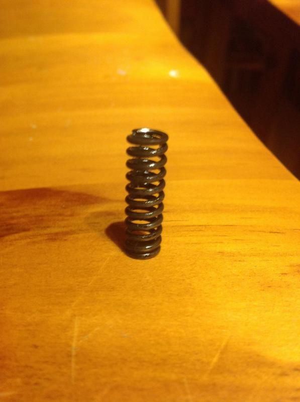

I found this spring on the ground just after I pulled the diff....
Might be relevant ? Or just some rubbish I had laying around on the floor?

If it's a rodchange box that's the main gearshift detent spring. It lived under the RH diff side cover. There was a steel ball behind it too... :wink:
