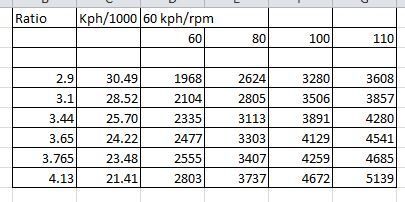

I don't have a tachometer hence the measurement method used to find out the ratio.
By calculation from a 3.44 diff providing 25.7 kph/1000rpm you get at 100 kph:-
2.9:1. 3280 rpm
3.1:1. 3506rpm
3.44:1. 3891 rpm
3.65:1. 4129 rpm
3.765:1 4259 rpm
4.13:1. 4672 rpm
I have only once done 100kph and the engine sounded like it was screaming so that's why I investigated what diff it had.

Looks like I may have a 4.1 diff as well. Starts getting noisy at 80kph.
But mine has other issues. The muffler looks like it has been burnt so maybe someone has taken to the baffles with a gas axe. Might download one of those noise meters and see what it is.

@ 100kmh (actual) GPS speed with my 3.647 diff and 10" A008s, I'm doing almost 4,400rpm.

I used the data for the 3.44 cooper diff in the Orange mini manual.
I then just calculated what the other ratios would come out at. It may not be perfect but should be very close.

Now we need to add the recommended BHP to pull each diff with say 10" control wheels :D
