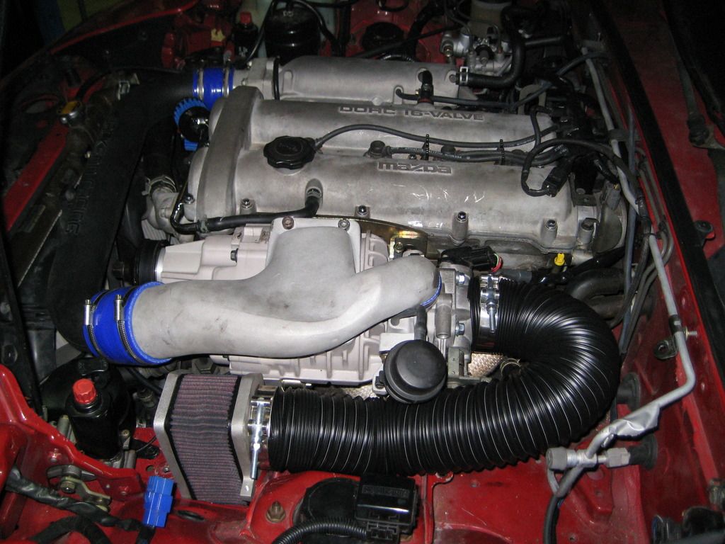

There are many versions of the Eaton M45. There are the ones that were fitted by OEMs like the BINI one and the ones fitted to various Mercedes cars. There are also generic ones you can buy that don't have the extras like the big snout inlet or the water pump drive that the BINI one has. Without those in the way the inlet is straight into the back.
Here is a pic of a generic one that was part of a Jackson Racing SC kit I had on my MX5.
This one has a cast outlet manifold to suit the MX5. It has an adaptor so the MX5 throttle body bolts straight up to it and it can use the bypass valve for idle.
There has to be a reason why all car manufacturers who fit M45 chargers use an idle bypass valve. My guess is that at low revs and with a high vacuum at idle the charge pulses make for a crappy idle. The bypass valve is vacuum opened spring closed so it closes as soon as you hit the throttle. None of the M45 kits for a mini appear to use the bypass valve. Maybe that is contributing to the issue?
