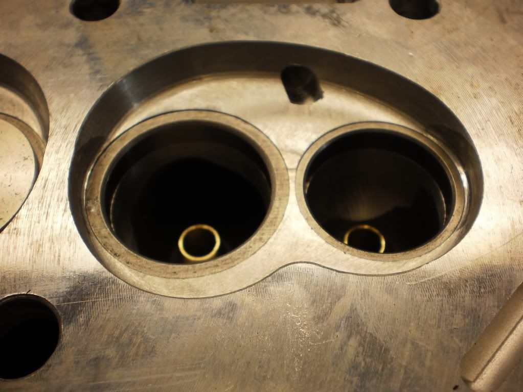

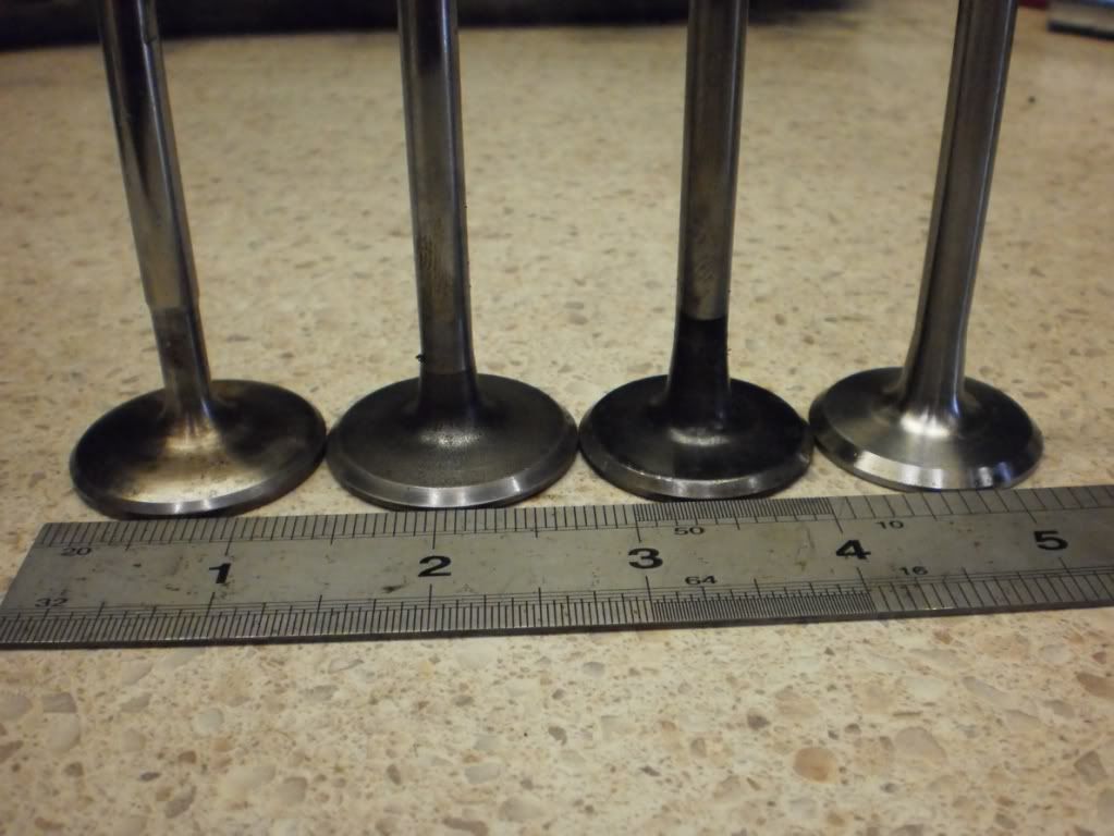

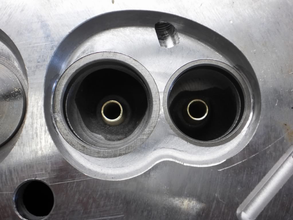

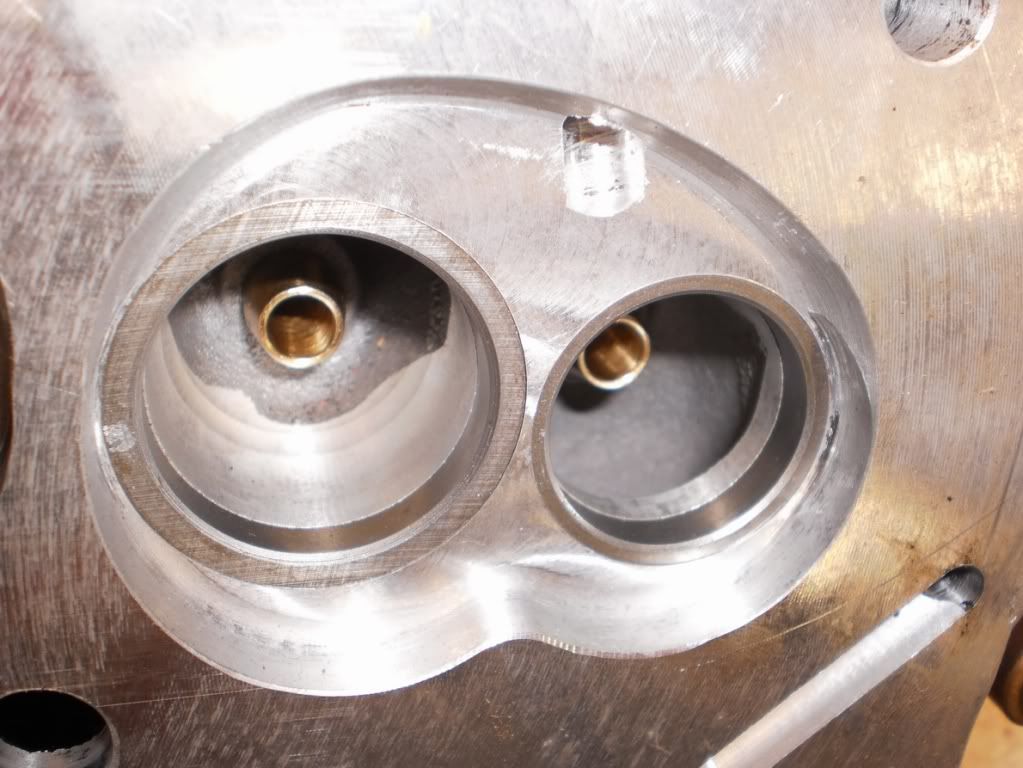

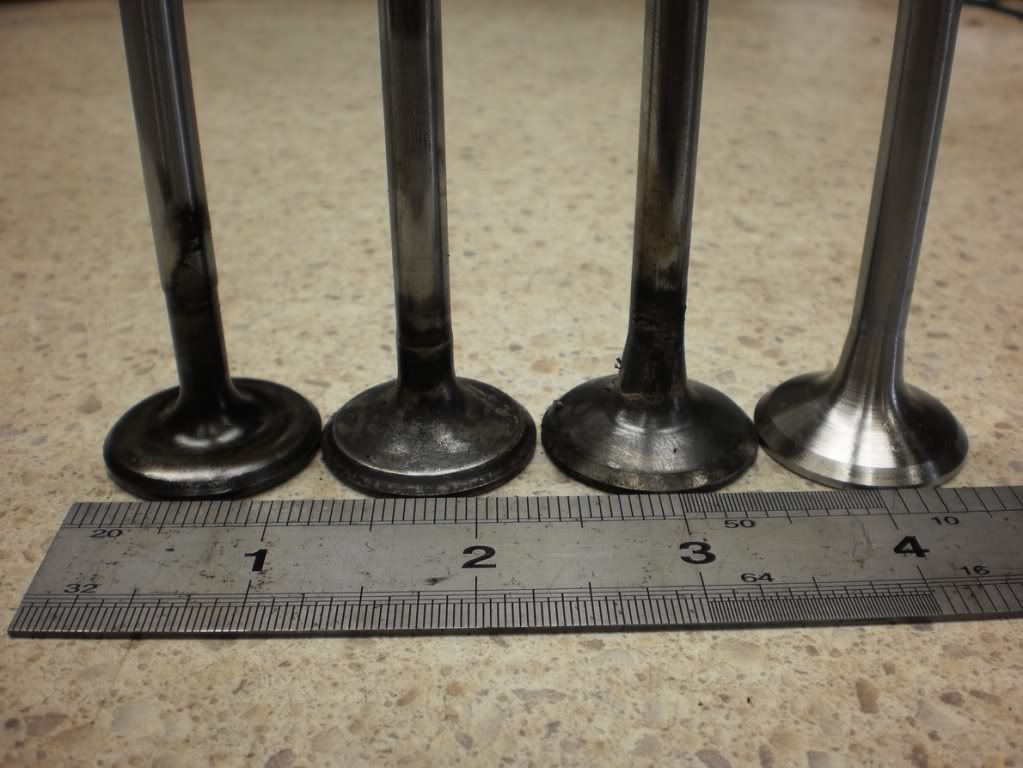

I've taken a pair of valves out to have a closer look at the head. The inside radius between the horizontal portion of the port and the pocket immediately behind the valve is very very tight and needs smoothing on moth valves. On the exhaust it is an even depth in the pocket but on the inlet it is a varying edge. I can take more pics if anyone's interested.
In line with older 12G940 standard (middle) and a late 80's MG Metro 12G940 as well.
I reckon the plug pocket is too sharp on the edges and the pluc tip actually lives way down in there so maybe it's worth opening it up a lot? The chamber volume may get too big then??
And the valves that came with it are the far right of these pics:
Exhaust
Inlet
