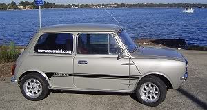

LS1380 wrote:
And after :D :D :D :D
Mate that is one awesome LS. Love the colour, is it an original colour? What sort of wheels are they?
Andrew
1973 Leyland Mini
1989 Mitsubishi Pajero
2014 Ford Focus
PostPosted: Wed Oct 11, 2006 11:37 pm
Posts: 2645
Giday mate..
Orginal colour - Nugget Gold.
Wheels- Performance Alloys(12's) :D
