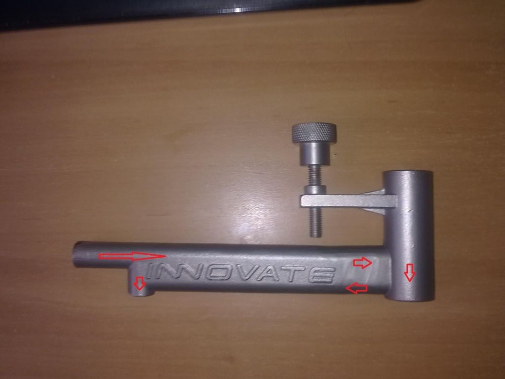

i have the innovate tailpipe clamp and i would recommend sticking the tube ( the part that catches the exhaust gas further up than on the bought one)
For 'fabrication' the innovate tube is 14cm long on top and rolls round and under - to flow past the sensor and then back ) it is 1cm diameter

I copied mine from the one GR uses.
It is a straight 8" long bit of 3/4" bore pipe, the sensor spud is welded on 3" from the aft end.
So there is ~5" of sensor pipe up inside the tailpipe.

All assembled now as a portable, is in car, will go for a test drive tomorrow.
I used an M18x1.5 nut for the sensor's mount, and kept the spud they supplied in case I want to weld that into the LCB's Y-piece as a permanent install.
8ft interconnection cable to sensor not shown.
