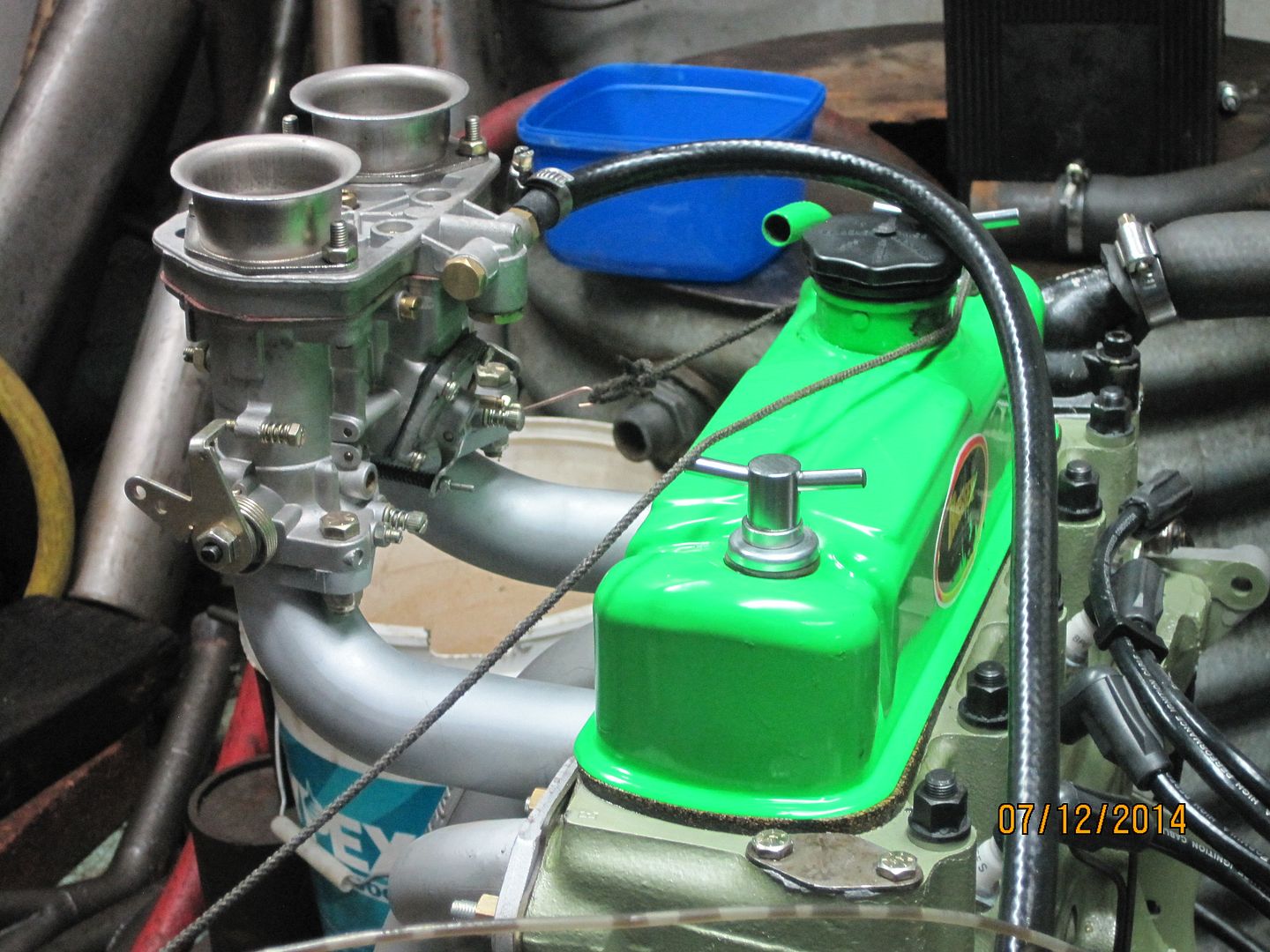

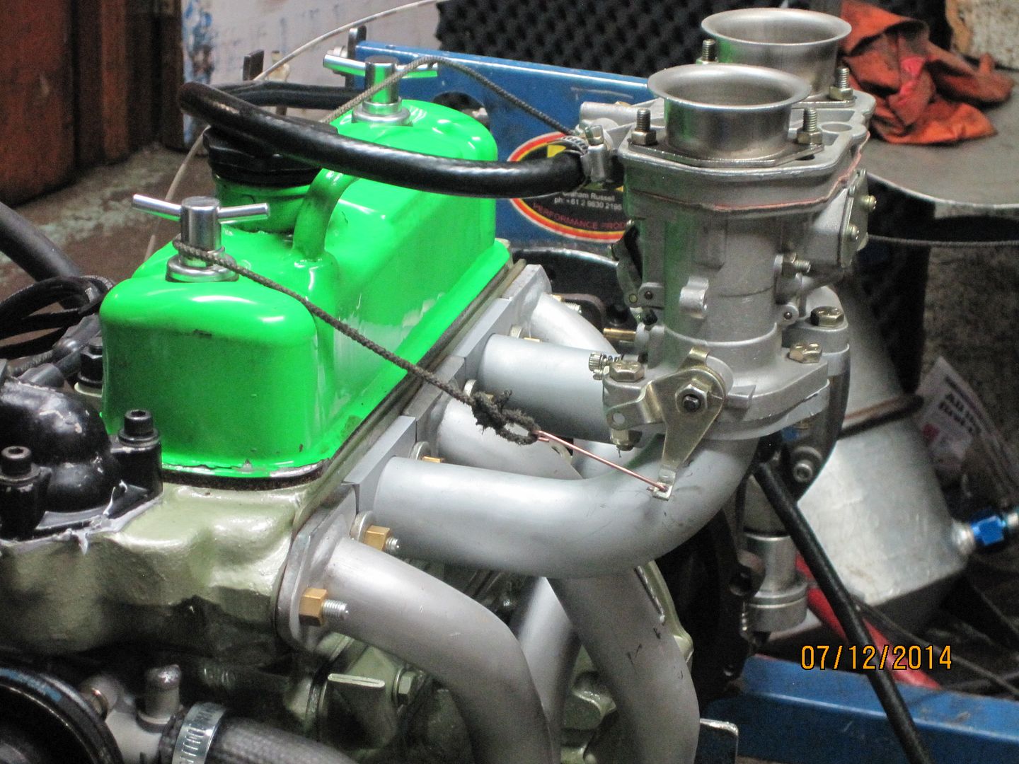

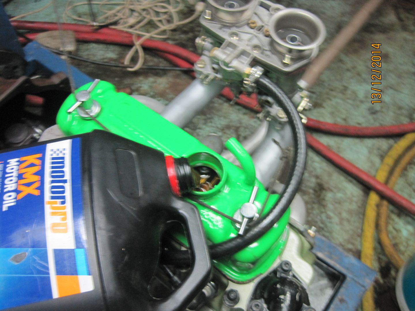

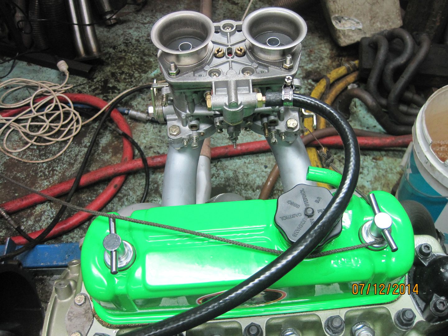

Hi All,
Here are some more photos that should have gone up before, showing more detail.
Aaron's Fault.
We have done more some more testing with a modified inlet port and an 1 3/4" SU. The results were very good.
These will all go up on the website, when Aaron gets his act together and types it all up....
Graham Russell :D

PostPosted: Mon Dec 15, 2014 1:28 pm
Posts: 11264
KMX still good?

Love the throttle cable

Posts: 18888
Does it sit well in the engine bay? Any clearance problems for an airfilter?

Oh dear, worry, worry...
Posts: 692
Location: North Rocks
Hi Mick
You have about 35mm clearance it seems to vary from car to car you can buy air cleaners that are about 25mm thick,but then again you could make a big flat one, and I think it's finer filter will make the foam to fit.
Graham Russell
