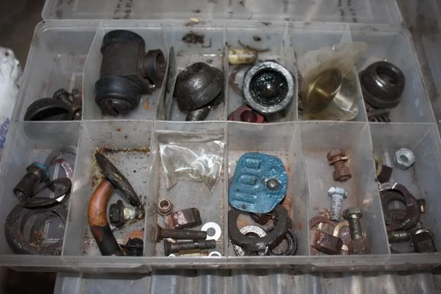

well i found a little container with random screws and other stuff, and guess what else i found.... Something that helps clear the engine size up a little.

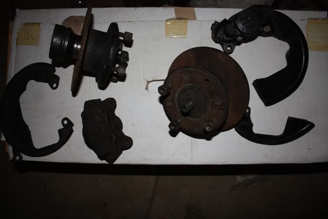

and while you're here, i have these little "bad boys" :lol: in amongst the parts.
it seems to have most of the parts. Any ideas on what else would be needed if i was to put these guys on.
The previous owner fitted a brake booster, presumably in anticipation of fitting these disks, but having read a few threads on here the consensus seems to be that it is not really necessary.
If that is the case i would rather remove it and gain the engine bay space back. As I am not too worried about having a firmer brake pedal. My old 72 clubman had un-boosted drums all round and that was fine.
Is there a big difference between un-assisted disks front, drums back and just un-assisted drums all round ???

Measure the diameter and thickness of those rotors. Pic is a bit dark but they look like 7" Cooper ones to me, not 7.5" Cooper S.
If so and you are fitting them, I WOULD keep the booster, and fit Greenstuff pads or better.
Well you were right ( again :roll: :lol: )
They are 7" , and 4.5mm thick
So are they a worthy upgrade ???? :?

People including Vizard bag out 7" discs, but like any discs they have 1 major advantage over 2LS drums on a road car- they self adjust. 8)
I ran a set for years on my `76 Clubby hydro Minimatic Cooper 998 disc bitsa, they stopped fine with a PBR servo and a set of HF metal king pads. :P
Cooper won their class a couple of years running at Bathurst, so they are not THAT bad. But Cooper S ones are better and more durable.
If ya got em, run em I say.

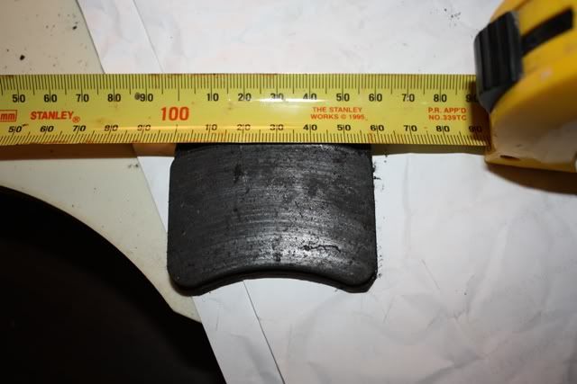

[edit] post a pic of the pads. If they are the 997 `postage stamps', the calipers can be milled out (by me or others) to take the bigger 998 pads.

here it is. :)

OK those are the good later (998) ones.
But fit some decent pads- EBC Greenstuffs, Mintex M1144, etc.
998 pads get hot quicker than S pads do.
Rotors are only 1/4" thick (6.35mm) when new, toss them if under 6mm. Karcraft has new ones available for a bit over $100 each.
A while back, they were around $150+.... :shock:
