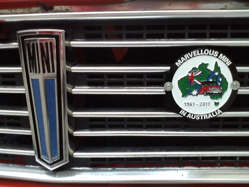

Put my mini 50 badge on.

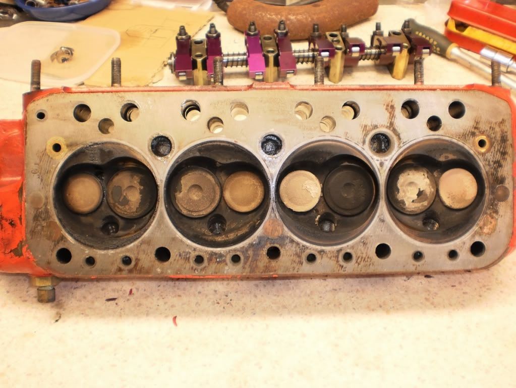

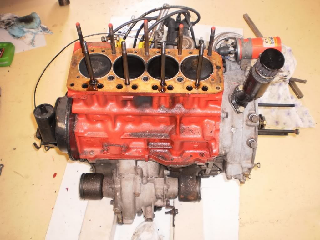

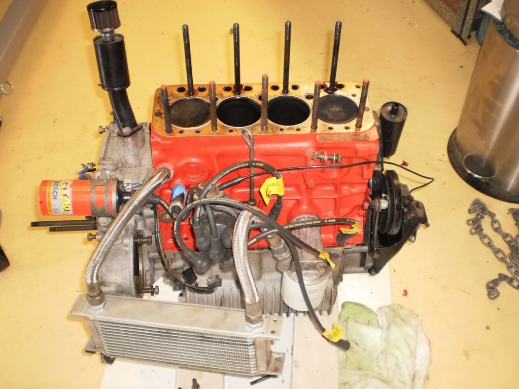

More progress on the Moke's motor. Took the clutch housing and pressure plate off but can't find my puller :( The oil that dribbled out of the flywheel housing when I took the wok off told me the source of the slipping clutch issues...
Took the water pump off and was very happy with the lack of corrosion given the years it has spent sitting.
Took the head off to check it over and replace the stem seals. The old stem seals are not brittle but very stiff. They were stiffer than those that I took of an old 1100S head I had in storage which were very similar to those fitted to the Pierce head so those have lasted much better than the Mokes. I'm going to try those viton ones next I'm sick of crappy ones.
Here's a couple of pics of progress:
The marks down the back of the motor show where the exhaust gasket was blowing.
I was happy that there was no significant wear on the rocker shaft but the ends of the push rods look a bit blurgh.
I also did some measurements of racks and played with some heads.
