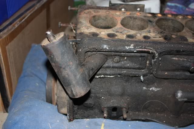

whats the difference between this, my old 72 clubbies 1098 engine
And this, the 1098 engine in my current car

Sorry it wasn't meant to be a trick question...
I was just wondering why the bit at the back is different. I circled the bit i mean.

I dont know why they are different, but that is a bolt on part that you can take off and swap whatever.
I would say one is a mini K motor 10Y and the other a clubman block 1001(something like that)
So an age gap that is my guess. :?
PostPosted: Sun Feb 13, 2011 8:07 pm
One is a very early Morris 1100 motor and the other is from a later motor with a PCV valve. (1100S, Cooper S, etc)
