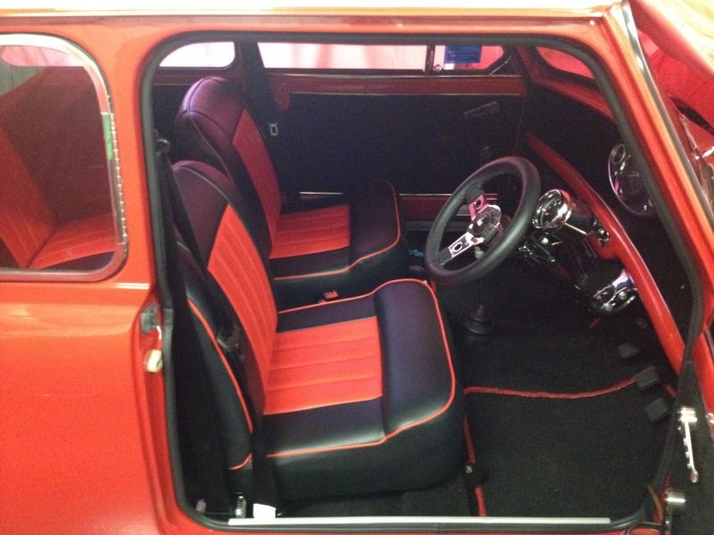

phillb wrote:
My seat bases are 440mm from the front edge to the backrest and approx 220mm from the floor to the top of the base of the seat. How do these measurements compare to yours.
Ok. Got some measurements.
From the bulging lower section of the seat back Seat back to front most piping of the base is 380mm.....
From right under the seat back at its most visible section to the front most piping of the base is 400mm
Seat base height at rear of base is 220mm
The carpet underlay is 10mm thick
Total height from the floor to the top of the backrest is 650mm
The backrest is tooooo thick...... And hats their fault. So maybe just maybe they can change that. I'll chop some underlay out and maybe that will work? Otherwise, I'll pay to get the foam base thickness reduced.

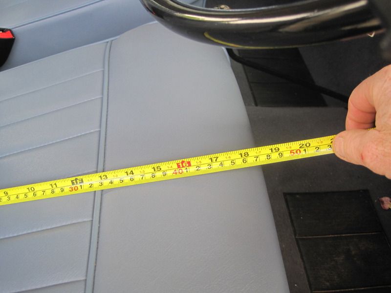

Here is my Mk 1 seats Brad yours are way to fat on the backs and the bases
Brad they are fatter then my Rover Cooper seats

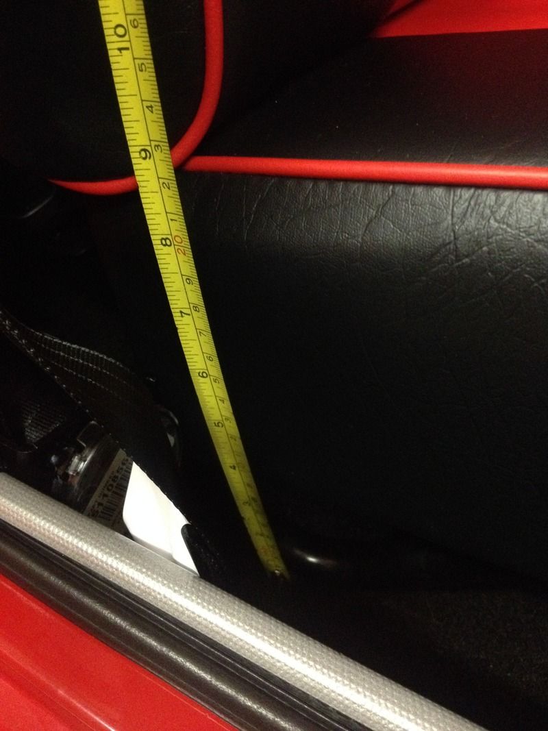

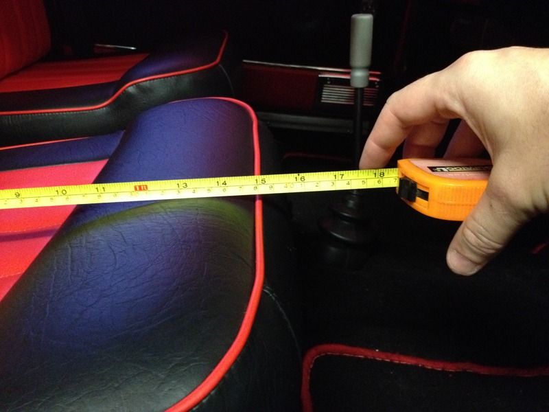

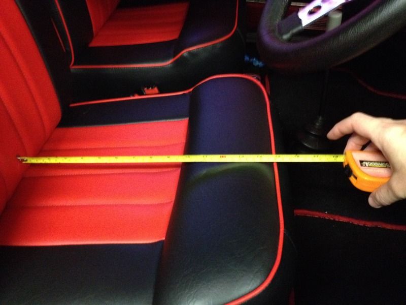

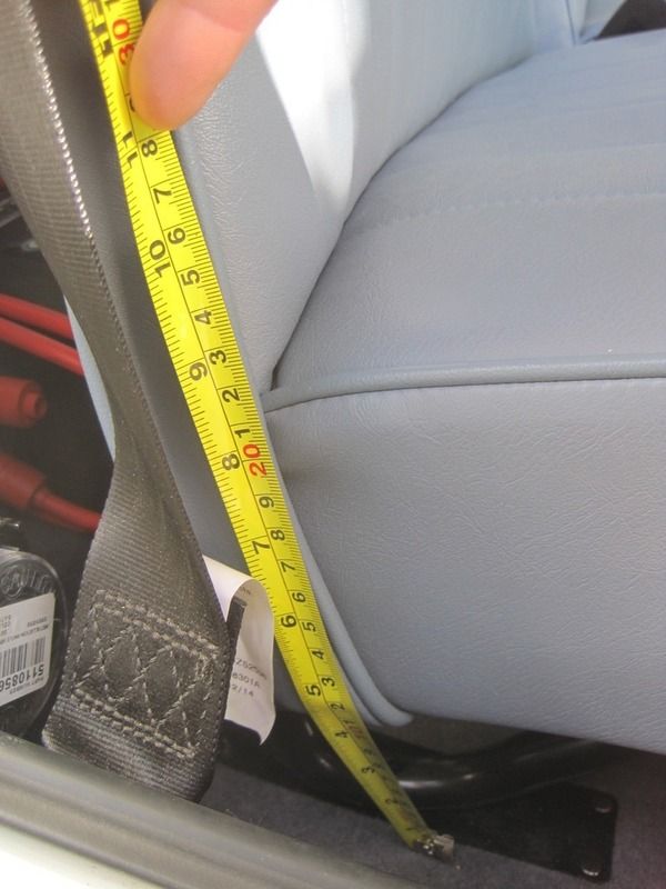

this photo is from the bottom of rear squab

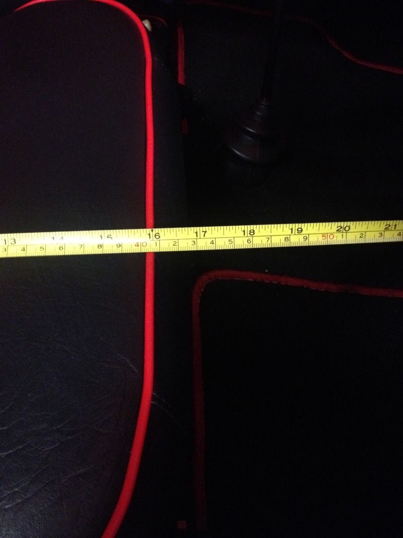

this one is touching the roof liner to where rear squab and seat base meet

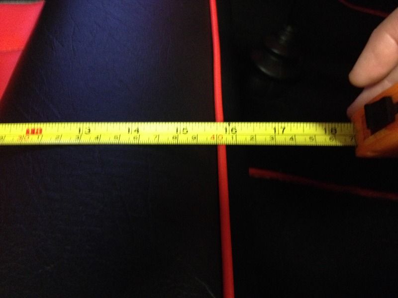

this obviously is rear squab to the floor at seat mounts
hope it helps

Wow. That's great mate. Massive difference in size there!!! I'll print those out and supply the upholster.

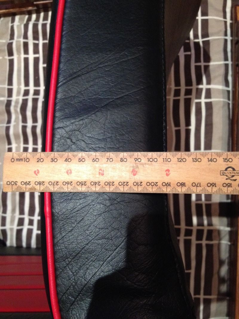

Ok comparo time.
Look at how thick the back rest is. 110mm

Hard to see in that above pic of the backrest, but the 0 mark is lined up with the bulged out section of the backrest, it extends further then just the piping.
