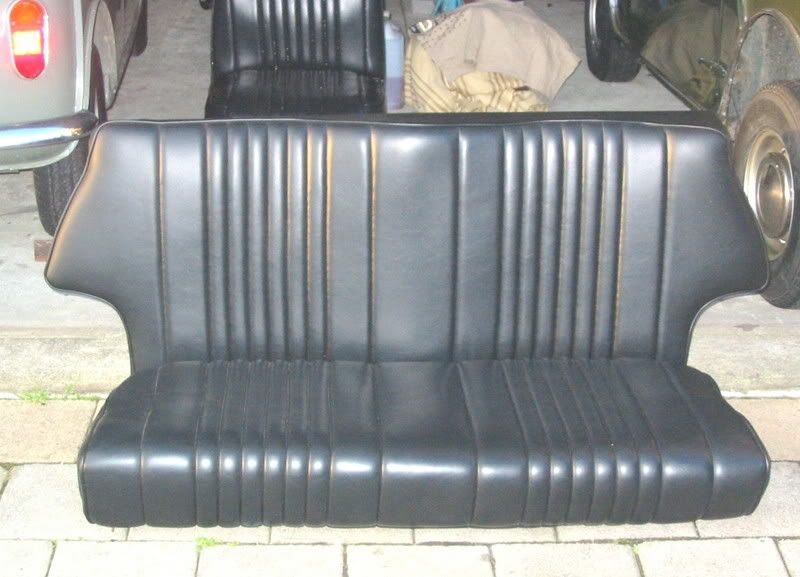

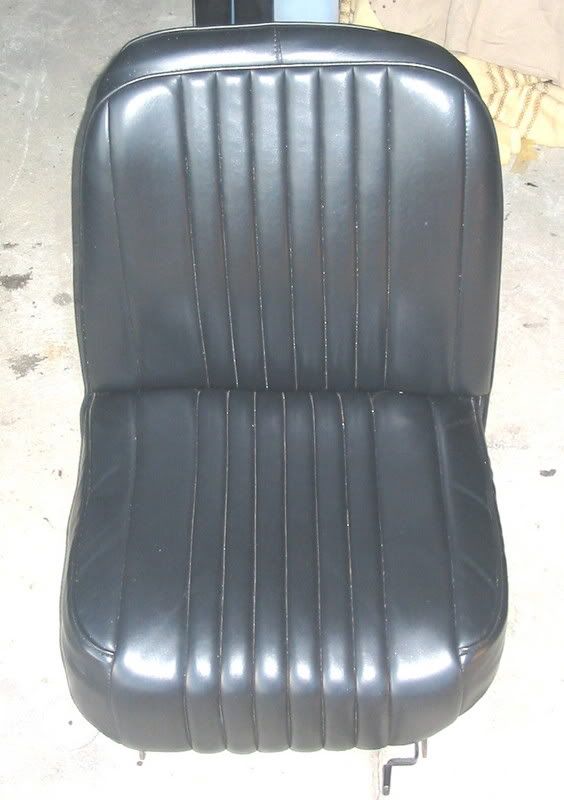

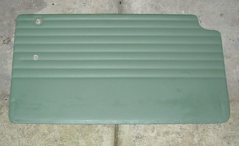

The first pic that you have posted is Mk2 Cooper S and Mini K , the second is early Mk1 Cooper S and Deluxe , which changed to pattern shown below , in 1966 sometime ( the 3rd pic you posted looks correct)
MK 1 FRONT SEAT 1966-1969
MK1 REAR SEAT 1966-1969
MK1 DOOR CARD 1966-1969

Some very late Mk1's can be found with Mk2 trim and other Mk2 parts , unofficially called Mk1 and a half by some people I believe
