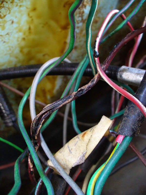

the drive to my work was fine...the ride home was...well short to say the least. got in the car (930pm) and started it up, switched the lights on for no more then about 2 seconds, before the lights cut out, and PLUMES of smoke came from the dash in front of me, and out the 'demister vents'....
i just immdietly switched off the car and called for a ride home..

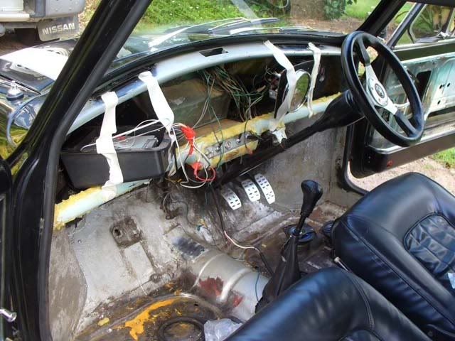

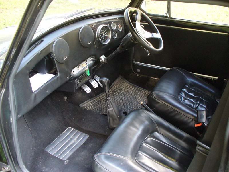

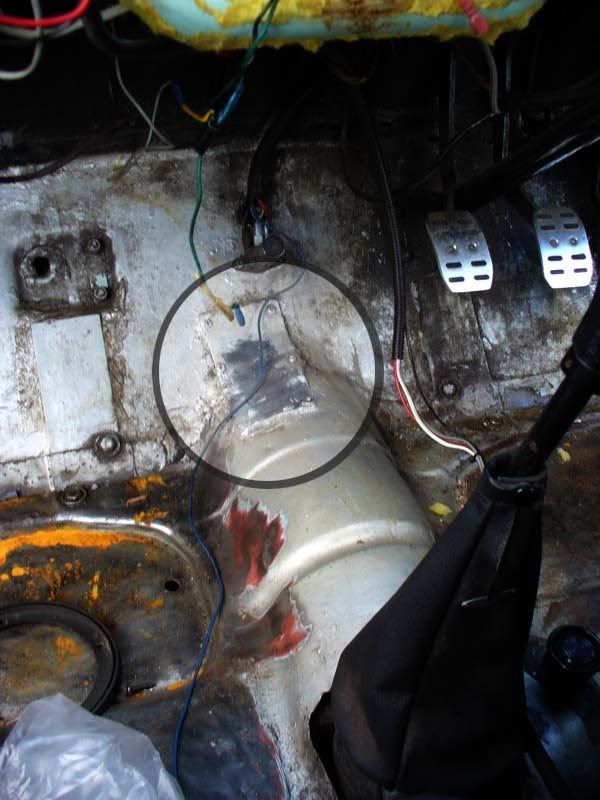

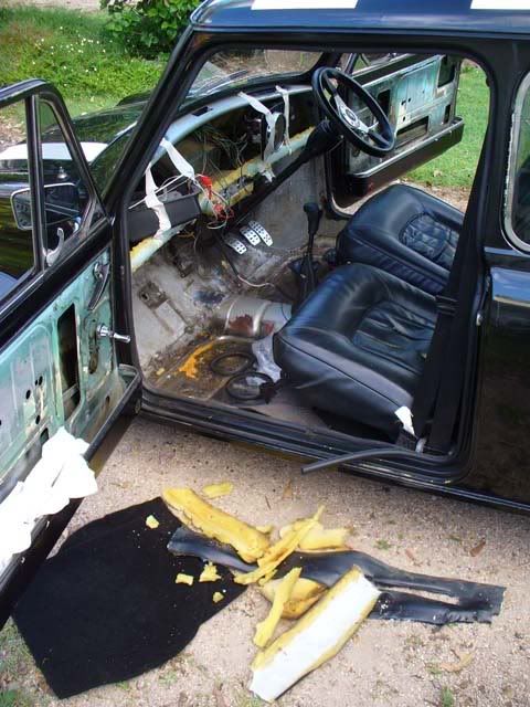

today i went to work in my tow vehicle :lol: and when i arrived home i preceded to try to see what went on behind my dash. the pics should explain a bit now...
my dash when i got the car
and now after i 'attacked' it all :(
the culprit???
tow strap still attached

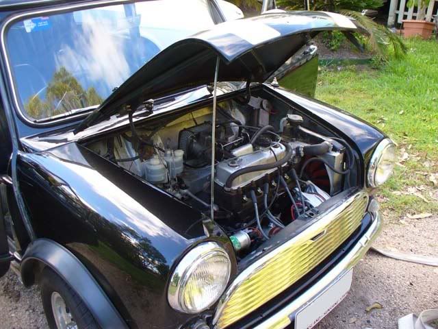

engine bay with the new altenator

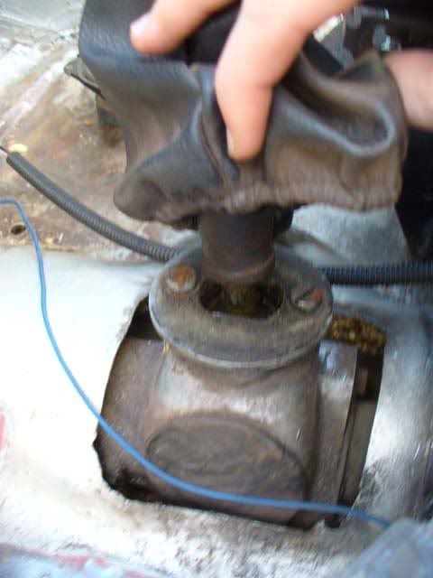

OH I FORGOT TO MENTION.....i believe that my car MAY be an 850...due to this panel thats welded as though there was a Majic wand gear box originally in the car. Also the fact that the new gearbox hole is rather 'roughly cut' gearbox hole, am i correct in thinking that it may not be a deluxe and is an 850??
thank you for your lengthy attention, i hope that its not something serious with my wiring loom or something :cry:

That looks like it would be a 850 shell to me, even the hole where the remote shift comes through looks smaller (and rougher cut) than the hole in my car. My car also doesn't have a 'patch' where the magic wand would have gone.
Surely you would've been able to tell from the compliance plate????
Good luck with rewiring - don't just replace the single wire that's burnt, you obviously have a problem elsewhere you need to fix.

Bad luck with the wiring, my best bet would be an auto electrician.

hmm yeah the thing about that....i cant FIND a compliance plate at ALL....i think that the previous owner took the whole compliance plate and all that when he was removing rust (it looks like new metal) in the engine bay pic, on the left hand side there is a rusting plate (near the black taped up wire with the red on it) and it has a NEW VIN number thing that was obviously put there for rego purposes to pass it...is there anywhere else on the body in which theres a number or somthing i can identify the body with?? cause the engine is an 1100cc (taken from a clubby in 76 i think)

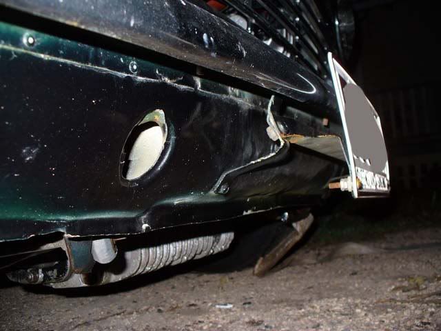

Show me a pic of the door catch. And a pic of the front valance (the valance will say if it's pre mid-64-ish, mine is about July '64 and has original style, full front.)

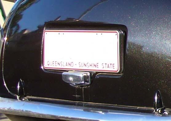

With out numbers is very hard. Magic wand hole is a good indication and your wipers do stop on the drivers side, which im led to believe was an early trait. Whats your boot number plate panel look like?

3 screw ay. They are british tail lights as oppossed to the aussie 2 screw. Which means the car is pre a certain date. If the front valance is full, it's a '64 or earlier therefore it's an 850 or Cooper, but since it's got magic wand hole, it's an 850.

also my wiper motor has a 65 as the last set of digits, but whether or not this has been replaced once or more times is a mystery...

From those pics, congratulations, you got an 850 there 8) . It was a sliding window Mini, but no longer. It's been modernised, just like mine. :)
(PS the front valance won't tell you much as it appears to be replaced.)

Did you install a Relay for the lights? Or was the full 85 amps from your new alternator travelling down to your light switch?
Might have been what let the smoke out.
You will need to check all of the wiring on that cuircuit, including the wiring to the tail lights, and replace. It may have also melted the nearby wiring, so check that carefully.
FIT a relay! Get the New ERA relay has two built in fuses. There is a how to on this site I think.
Carry a fire extinguisher.
Good Luck
