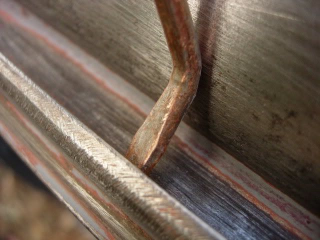

spraycanmansam wrote:
I've recently done my Mini ones and I've just done the ones on my Morris. Make sure you get any bog/putty/seam sealer out of the seam... Get something sharp and pointy and dig it out as water gets in behind and rusts out the seam
This is what I used after using a small wire wheel. A small screwdriver with a bend to get at the seams:
Regards
Dave K.
PostPosted: Wed May 28, 2008 7:46 am
Posts: 11749
Thats a great pic - very artistic. I like the wire wheel marks too 8)
