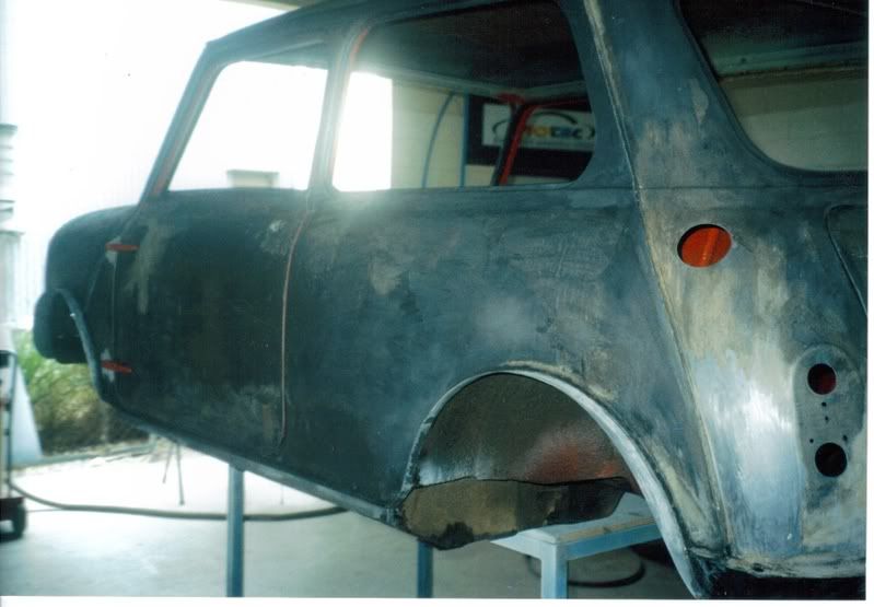

My car sat for a month or so after it had been blasted back to bare. Im not sure what it was covered in but it looked like this. Ill hit my mate up next time Im talking to him and ask him what he covered the car in.
